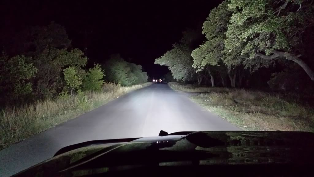

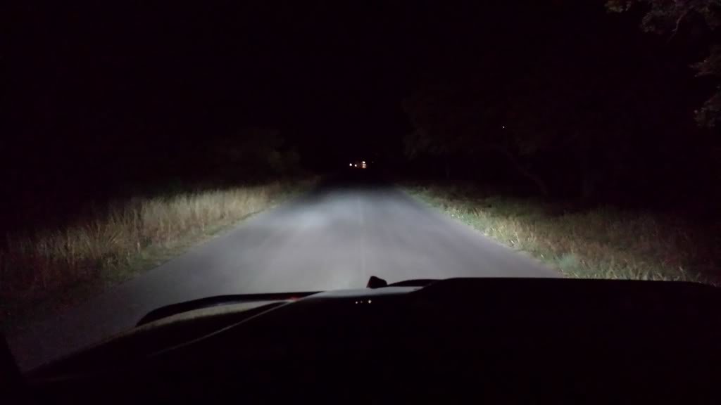

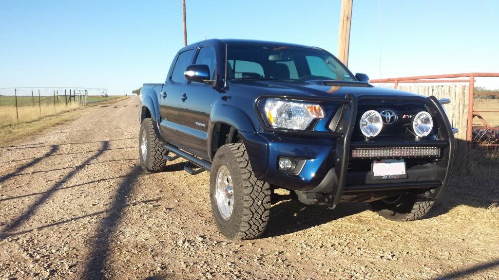

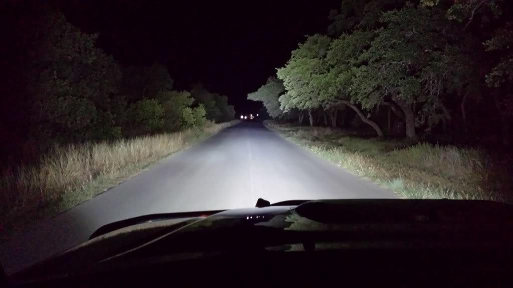

    I agree with everyone...LED Bar for short to mid range - filling in. HID/Spots for long range.
    Both LED & HID/Spots are the perfect combo:
    Hella 700FF 55W HID conversion
    32" Totron 180W LED all Spot
    35W HID headlights only
    LED light bar only
    LED & HID spots

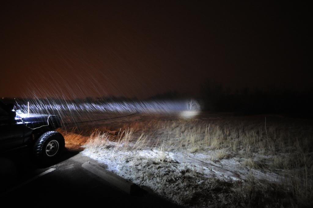

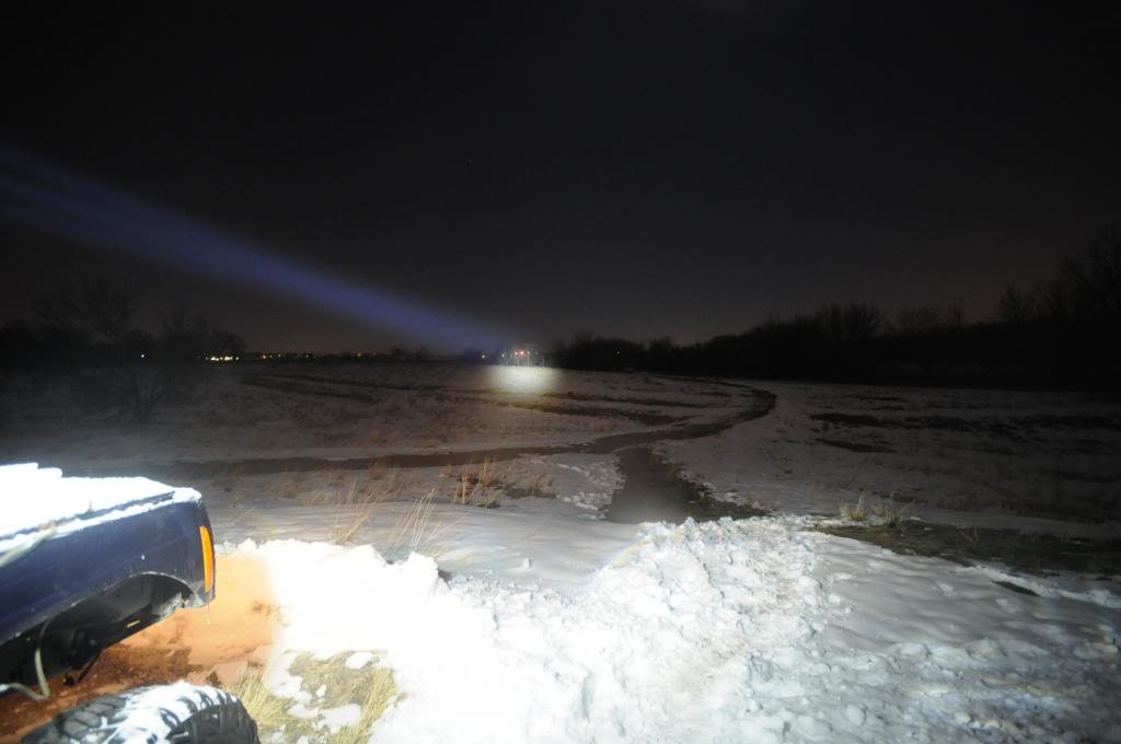

    If you want long range and minimal draw you just need to find the right LED light made specifically for long range.
    Here are a couple examples of single Long Throw Style LED Lights. Light Placement make a huge difference as well. A Low Mounted LED Light will not throw as far as a roof mounted LED Light.
    These are LED's with optics designed for long range to compete with HID Lights.
