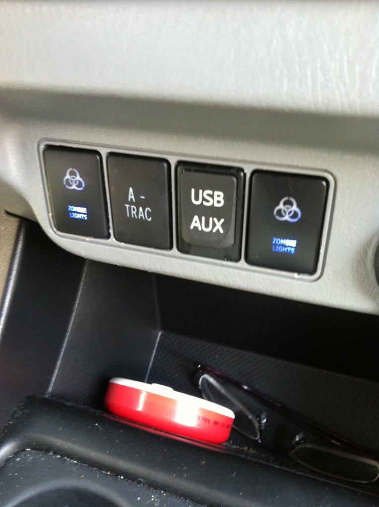

    The easiest way would be to use the switched wire for the high beams (use a multimeter to determine whether the positive or negative is switched). Run that to your switch to control the relay. On my Tacoma I used a double pole double throw (DPDT) switch so that if the switch was thrown up it was always on, middle it was off, down it was controlled by the brights. I probably didn't do the best job explaining it but here's the link to my post about it.

    Yes. Unplug the light and have someone switch high beams on and off while probing the connections with the multimeter. Be aware that some vehicles switch the negative, not positive. I'm not familiar with the 2nd gens. There are some people on here very knowledgeable on wiring diagrams that may be able to tell you what color wire is switched.
    Edit: Also be aware that if the negative is switched and you tap the wrong wire to control the relay, your light bar will stay on when you turn the key off. Ask me how I know...
