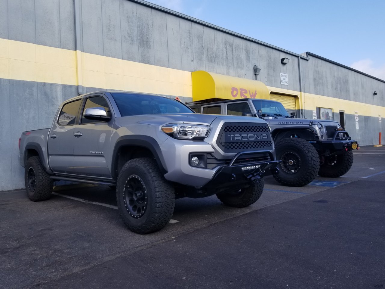

    I'd heard that too about having them below the headlights but I just got a fixit ticket today in San Diego. I told the officer what I'd heard and he told me to look up CVC 24411 and it says nothing about it. Here's a pic of my setup. Just ordered the light covers... :/

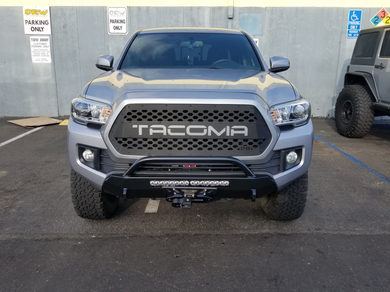

    I've been thinking about putting a 30 inch led bar behind my front bumper, but looking at § 24411 it seems that a 30 inch led bar has the potential of violating the statute in two ways; 1.) a LED light bar has more than 8 individual headlamps unless they consider the bar as a whole to be just one headlamp 2.) with the LED bar behind the bumper there is no feasible way to install an opaque cover over the LED bar and it would then be a question of police discretion to enforce § 24411 if they so choose. Out of curiosity, and hopefully your still monitoring this thread, in the ticket was he specific about what the violation was? Namely, did he specify that it was because the number of headlamps exceeded 8 or just because it wasn't covered?
    Regardless, makes me nervous about pulling the trigger on a led bumper bar because it can't be covered.

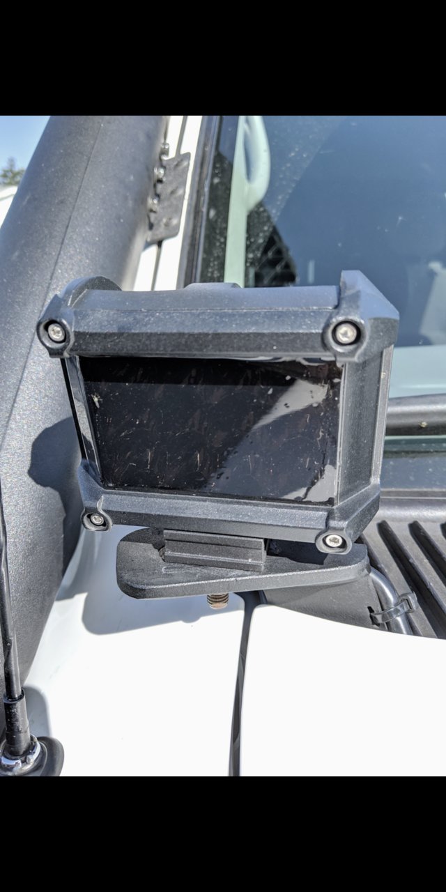

    I have the Auxbeam side shooters and obviously no covers made or available. Was going to swap them out for pods with covers but then had a really cheesy idea lol
    I used some leftover privacy window cling/vinyl :rofl:
    https://www.amazon.com/gp/product/B000HE57JS
    Have had it on for a couple of days now and hasn't come off even with freeway driving. Blacks out the lens so satisfies the legal aspect. For now, it works.

    So far so good. Haven't had time but I have enough material leftover to cut a few more for spares and just toss em in the truck somewhere.
    At some point I'd like to find covers but whatever works.... looks like a huge ripple/bubble but it's just reflection of the fender

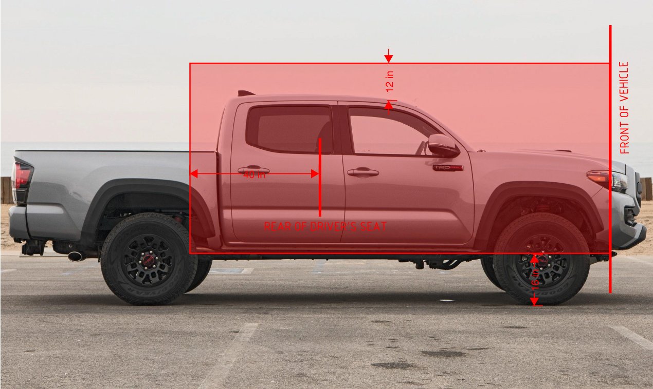

    Anything that falls under CVC 24411, which would be lighting in this rectangle:
    You can have use on your vehicle up to eight auxiliary lamps as headlamps when driving or operating off the highway that are not less than 16" above the ground, more than 12" above the passenger compartment, To a point 40" behind the driver's seat to the front of the vehicle, as long as these lamps are wired separate circuit from your primary lamps. On the highway, they must be covered by an opaque shield or cover, and turned off.
