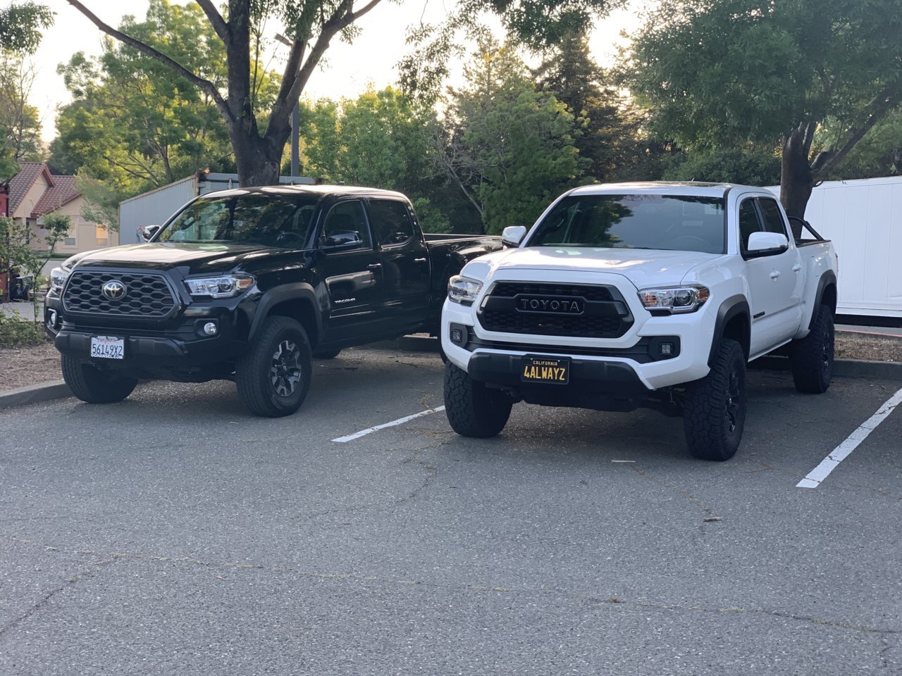

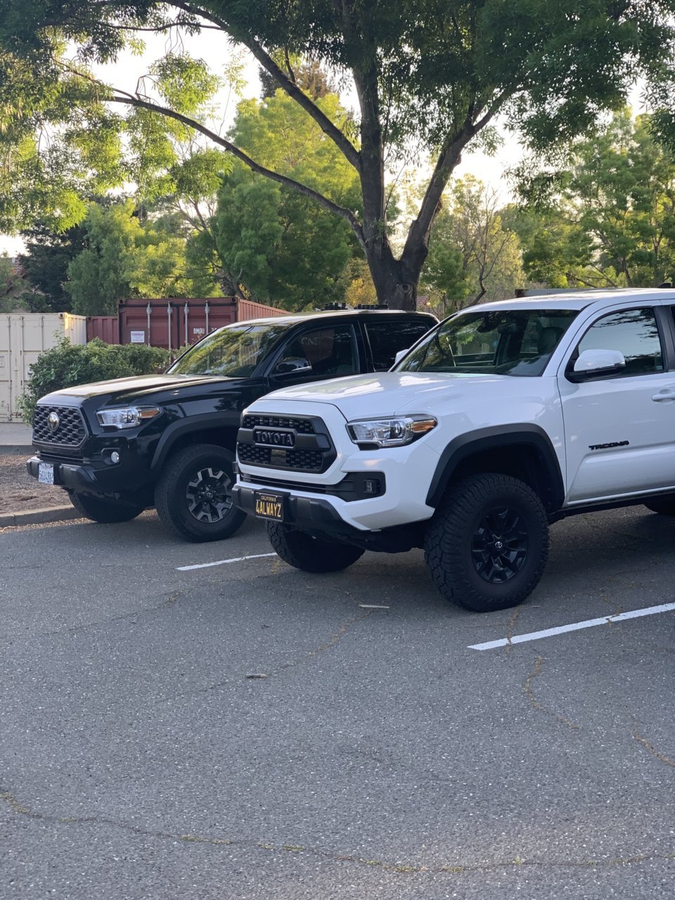

    1.5” front 4 setting / 1.5” wheelers aal rear with 265/75/16

    What are the hub to fender measurements?

    Both! In the spirit of comparison

    35” front and 36 5/8 “ Rear stock Off-road / mine is at 37” front and 38 3/8-1/2 And yes I had a measuring tape in my tool box I grabbed it and went out to measure it. Also I do not know the owner LMAO!!

    OP. Nice thread. Definitely good to know how the bilsteins stack up against the stock suspension. Thanks for the Info and pics!

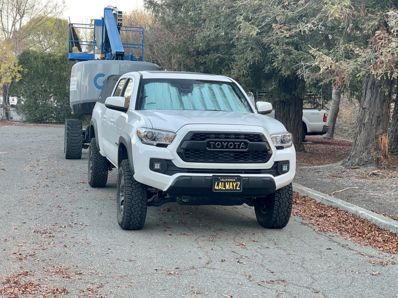

    recent shot 2” up front adjusted :thumbsup:
