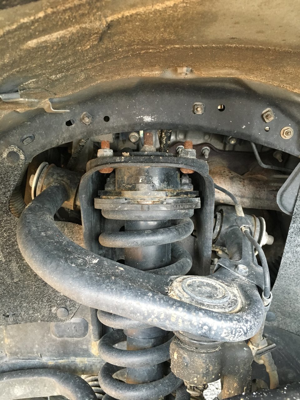

    Ok guys, I have a 2011 TRD Off-Road that I bought used about a year ago. I'm finally getting around to doing some mods for myself. My previous truck was a 2007 TRD sport so I'm not familiar with the OR suspension. I know it has 2in blocks on the back but not sure about the front.
    My question is... in the picture below is that an after market spacer or is that part of the OR package?

    Aftermarket spacer on top​

    Yup that's a Hockey Puck Spacer Lift

    There is no stock block in the rear. Anything on the axle or under the leaf springs is aftermarket.
    And yes, aftermarket coil spacer on your front coilovers.

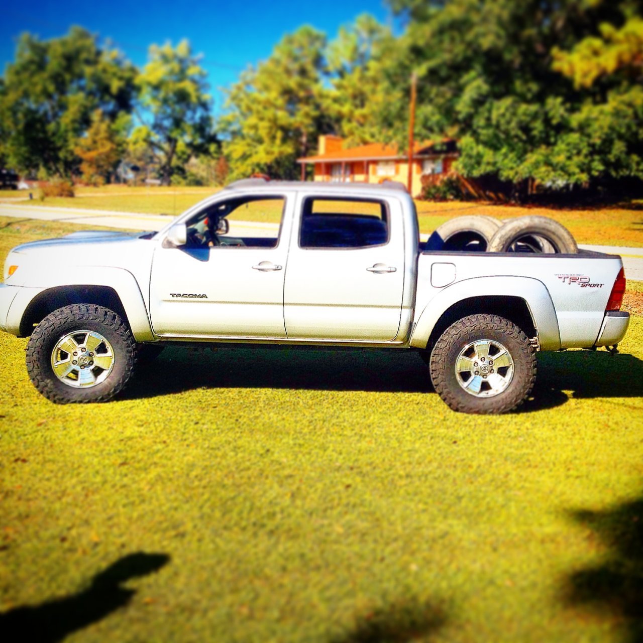

    Byron
    2011 4x4
    I have been digging around for weeks and it appears everyone does it different. Like I stated before, My previous was an 07 Sport (ill throw a few pics of it in below) and I threw the Supreme Suspensions 3in Spacers and 2in blocks (lack of funds and knowledge to know any better) on and cleared the 295/70/17's with minimal rubbing. Most threads I have read, say that 285 is the most you can run without cutting your truck all apart. I barely had to do any trimming. I want to get back to that size but do it the right way. I am going to continue researching but at least now I have a thread I can ask questions on.
