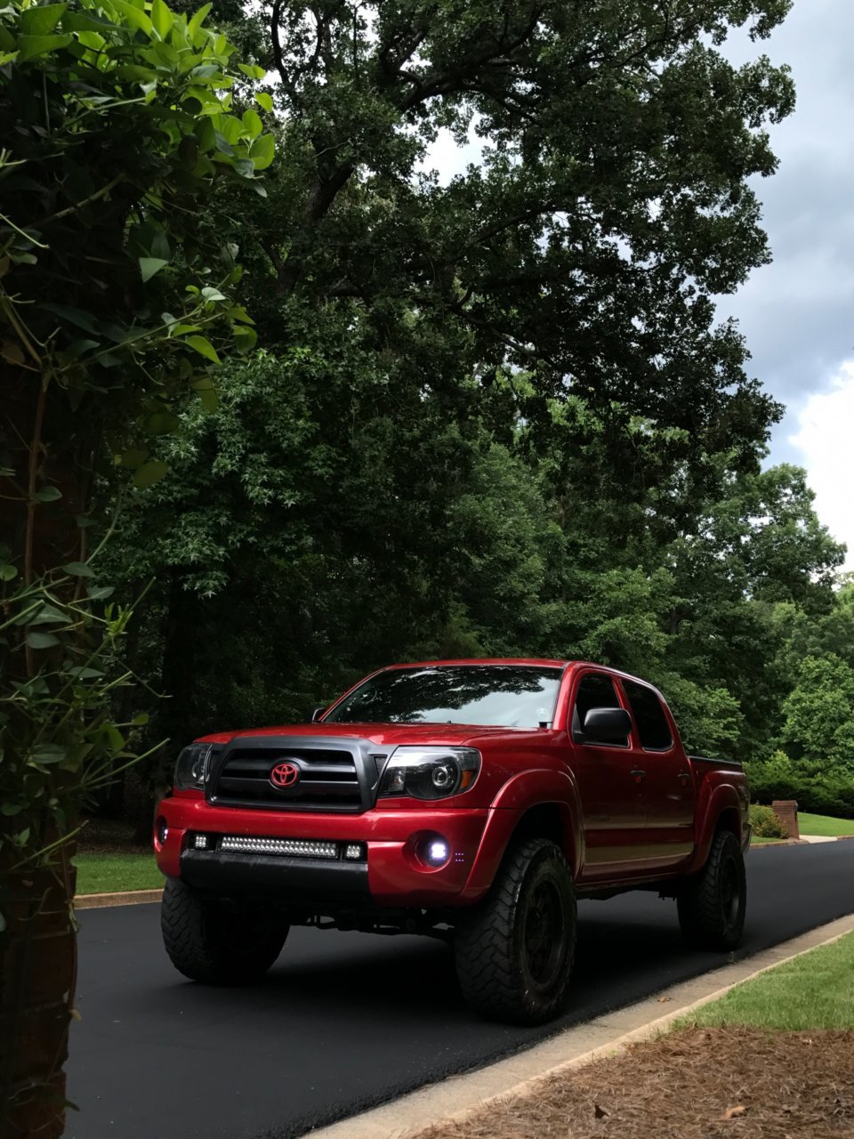

    Good Morning!
    Dealing with my son's 2010 Tacoma Prerunner (with the locking rear Diff.) whose rear differential has to be replaced. This is the second time this has happened. The original factory one and, now, the replacement rebuilt one. Ugh. He off handedly mentions something about the big tires and lift possibly affecting his Rear Diff. So, I need to ask you all. Is it possible that his rear diff has gone out because of anything to do with these big tires and a 3" lift? He is a student and doesn't pull anything heavy. Thank you. :)

    Sounds like he is beating the shit out of it. I’m turning E load range 35s on my stock diff and haven’t had 1 issue

    I suspect it has less to do with the lift and tires than the way the truck is driven, or, the quality /reliability of the last rear end you put in.

    Maybe by driving around on pavement with the locker on.

    Yes changing the angles with a lift can indeed cause problems.
    3” is not uncommon, but once you cross the 2” mark there are steeper angles and relevant stresses on all parts, especially if the lift was done on the cheap.
    Larger tires in and of themselves are not a big concern unless his driving style is to purposely do burn outs on corners a lot, again adding stress to the parts.
