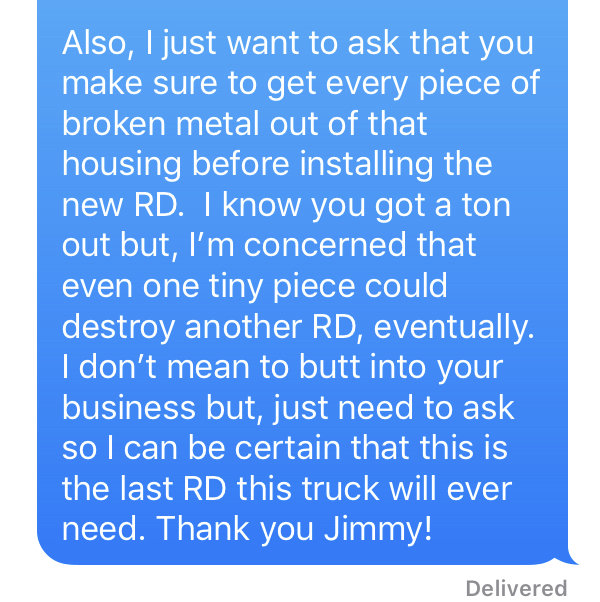

    Thanks for the process. Good to know. I hate butting in his business but, I do need it done correctly. I sent him this text earlier but will ask him to do it your way to be sure. And pay him accordingly. Men don’t take kindly to being told how to do something from a woman, usually. Ugh.

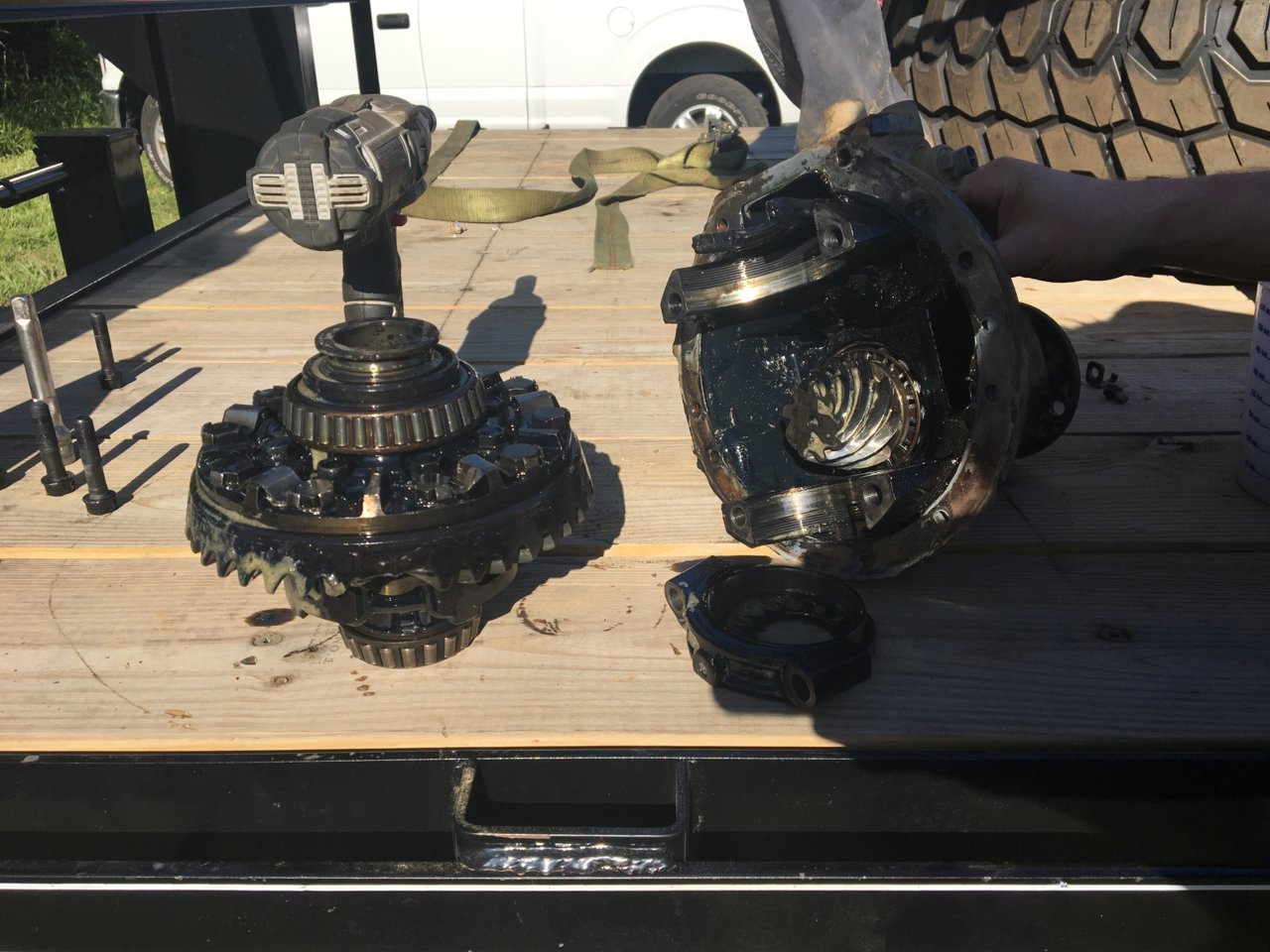

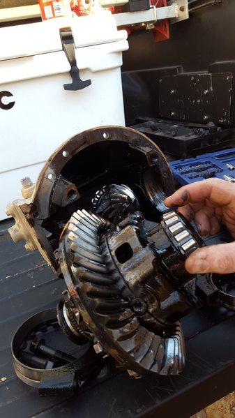

    even tho a Toyota mechanic says it was the oil, that type of damage in those pictures the gear teeth are shredded and broken which has to be from catastrophic lockup of the rear I.E. the Diff locker was engaged while driving on pavement. Toyota specs a 75w85 GL5 gear oil which is a super thin gear oil but using it wouldn't result in the damage shown here.

    From the look of the photos uploaded, I'd say it wasn't the oil that caused the damage. The gears look like it took a tremendous amount of force to chunk up that way.

    man those gears are chewed up. I have blown 2 rings in the rear diff, both during locker engaged while offroading. my truck was really heavy. 2015 trd offroad 4x4.

    Gears being stripped and damaged in the picture you've shown need a tremendous amount of force loaded on them to create that type of breakage. Sheering teeth like that I've seen in Moab, UT when rock crawlers slip backwards down the face while the wheels are spinning then regain traction, like that amount of force. The weight of the vehicle + engine spinning + sudden stop = damage, i.e., sheared ring teeth
    I'm a fan of giving a new driver a low hp vehicle so that they can appreciate upgrades and learn to respect what they have. A $25K truck right away isn't the best move even though safety is a concern. There are plenty of safe economy sedans out there.
    Also, a full time student means student = job. He shouldn't be out socializing in a manner that destroys $2k differentials. Maybe bowling with friends for a few hrs then having your nose in the books is a better habit to form.
    I'm sorry to criticize or point out some social weaknesses, but there are a lot of holes in several stories laid out in this thread, as well as, lines of thought that are a bit too convoluted.
    The damage parts do not lie. They tell me how much force was require to break, therefore, what actions create that force, and subsequently behavior that led to those actions.
