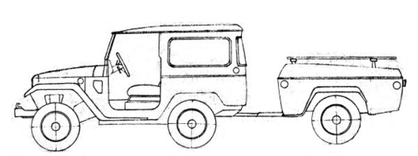

    I drew this today just for the heck of it
    (One of my dream set up's, A 1967 FJ and a Trailer I drew to match the FJ's style.) Just thought I'd share. The scan didn't come out great. It's pretty detailed in real life.
    I'm thinking a surf board would look pretty good on those cross bars. Maybe as a set up for some expedition surf trips. (Just to clarify, I kinda suck at surfing, but still think an expedition surf rig would be fun)

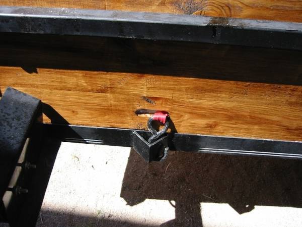

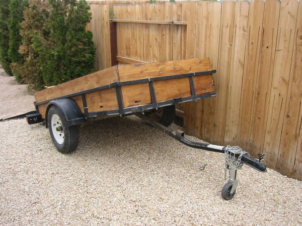

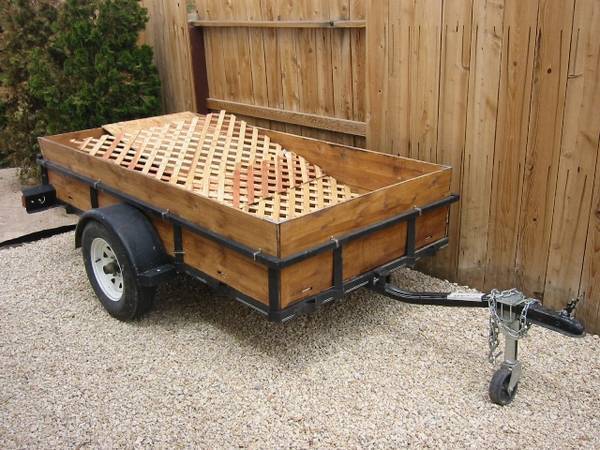

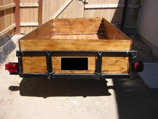

    For what you're talking about doing, something like what I have works just fine. I've drug this thing all over hell's half-acre through the Sierras as well as the NV desert and never had a problem. It's been down old mining trails that haven't been roads in probably 80 years. The only damage I've done to it is backing it into the fence (by hand, no less :rolleyes:) and busting the taillight. It's 4x8 with 13" rims and a 2K GVWR. It's small and light, but still big enough to haul plenty and can be used as a quickie tarp camper if needed.
    It has a tilt box which comes in real handy for loading bikes or a 4-wheeler.
    I picked it up used from a local trailer dealer. I had a welder whip me up the tailgate frame and install the tiedown brackets on the sides. I have it set up with quick-release pins so I can just pop them then lift the tailgate straight out. I replaced all the wood myself. The fact that it's still open keeps it available for use as a utility trailer around town as well.

    This looks great! I will have to spend some time looking through that.
    Yeah, this is about what I'd want. I think I'll be adding a few more accessories to mine than this has, but it would be a great start. And it's kinda like what I was hoping to accomplish with the HF trailer and some wood and fab'd sides.
