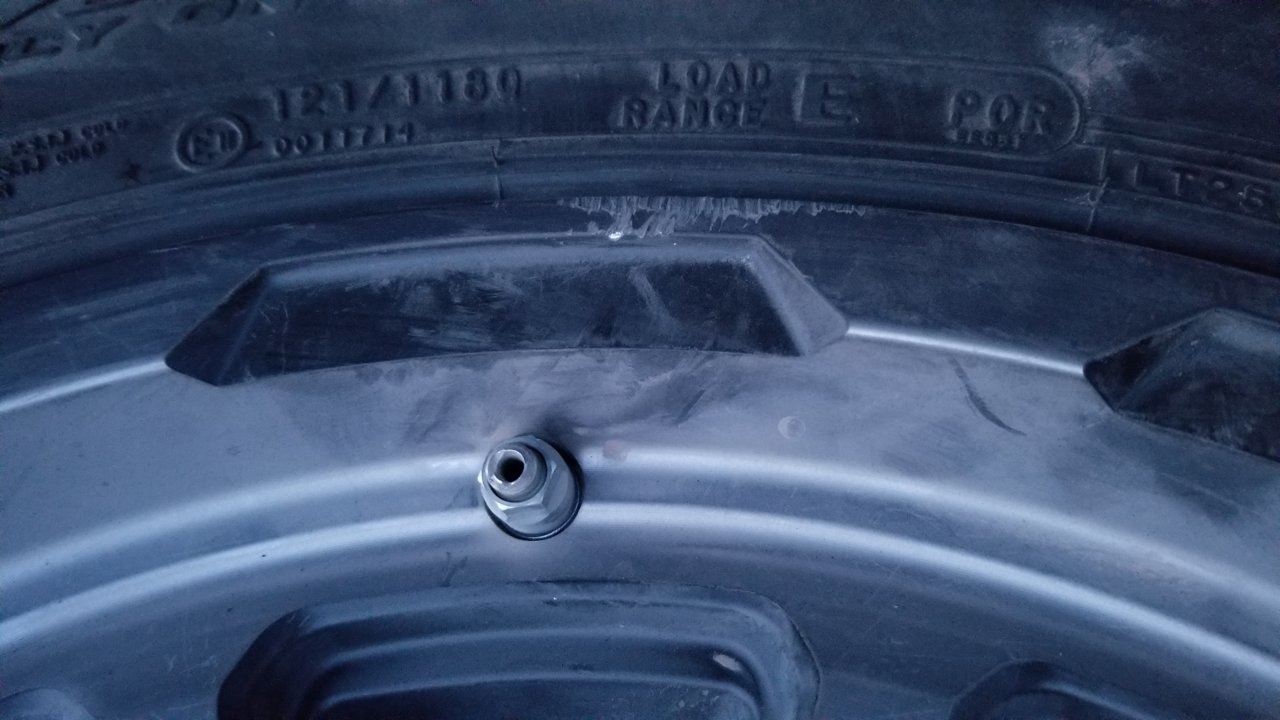

    Out today in my 2018 on a sketchy sideways area of the rocky trail a rock sheared off the valve stem. The metal TPMS stems do not have any flex at all. I'm looking for a solution but it looks like all the low profile or the easily field replaceable solutions are for the rubber valve stems not the rigid TPMS sensor stems. Now deciding if I'm going to just remove the TPMS sensors since it only came on most when it was cold or driving up.to.colder high elevation and almost always was the spare. I have an on board air compressor so checking and setting psi is no big deal.
    Does anyone have any low profile stem options and field repair from the exterior options or recommendations.

    I'm assuming with the TPMS sensor you can just undo the 12mm exterior nut then let the sensor just bounce around inside (probably ruin it) then nstall the field repair one from the outside. This way you don't have to break a bead and just repair it when you get home.

    I'm also pretty sure you can't separate the stem from the sensor, so once the stem is broken the whole thing is trash anyway. Doubt having the broken TPMS bounce around inside the tire would do any damage. At least not until you could get it repaired.

    I think I'm going to install the permanent Colby Valves and have some as a spare. I plan on putting the registered TPMS sensors in a pressurized PVC tube I make to trick the computer so the light goes out. Some guys I know did that. With the Colbys you don't ever have the problem of a rubber ball or a TPMS sensor remaining in the wheel that you then have to take out. Colbys are expensive but cheaper than TPMS and low profile and you can't beat how easy they are to change.
