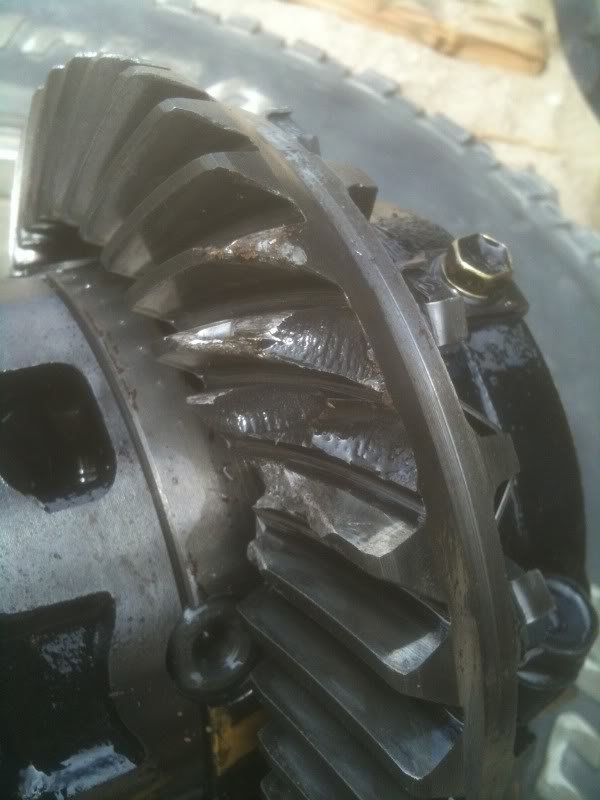

    I've blown up 4 8.4's :anonymous:
    but I have no pictures or proof so this comment really holds no weight.
    3 in my 09 reg cab(abuse of an 18 year old)
    and one in my 07 access cab 6-speed(got tee boned blew 2 months later)
    not talking shit but neither is bullet proof in my opinion even if my 8.0 has treated me well for the last 70k

    May I ask how you blew them up? And what parts did you destroy?
    You weren't.......... say activating a ARB RD129 while doing 40mph were you? LOL

    The reg cab, I don't know what was happening there. All I know is three separate occasions the rear end started to growl loudly under engine breaking, I brought it to a Toyota dealer they said they found large chunks on the drain plug and replaced the third member. Never got a technical explanation.
    The reg cab was off-road virtually every day and I drove it as hard as I could in every scenario often turning on the auto lsd mid burn out. I drifted it hard and often, jumps were common and i generally abused it. It also had no major modifications to it just a crappy spacer lift and near stock size tires

    The thing EVERYONE has to realize about the 8.0 elocker being "weaker" than the 8.4's is that 90% of the time, the 8.0's that get destroyed are on built rigs running bigger tires and getting beaten on with the locker engaged.... this means MORE STRESS... when you are pushing the truck up a ledge via one rear tire only when one is in the air and the fronts are on loose shit.
    the TRD OR's get wheeled to harder places simply because they can make it there unlike the 8.4's open diff, and thus see more stresses. If one was to wheel in 4low with the 8.0 not in locked it would fail at the same spot as the 8.4

    The reason why I think there no problems with the Sport rear diff is cause you dont have people who slam the rear locker on under pressure not cause its weak as shit like poeple describe. My last one was a Sport and I had a clunck in the rear diff and had parts replaced under warranty and not one problem with my current offroad yet :D

    the people who snap the 8s are the ones who dont know how to properly use it and engaged it under pressure but thats my opinion

    So your theory is that no one with ARB RD129's in Sport models offroads them and has larger tires :rolleyes:
    please put the pipe down
    The guy I know who blew his 8.0 up twice and swapped it out for a 8.4 w/RD129 has never blow up the ARB since. He also has more experience then any of the web wheelers I know on here.... same guy routinely makes international trips with his Tacoma and wheels pretty much non-stop. Same 'inexperienced' guy was the only person to find me an engine when mine blew because all his buddys are dropping larger engines in their Tacomas. But yea.... he must not know how to push a button :rolleyes:
    Amazed even with proof you guys won't admit the 8.0 is weaker.

    Yes technically the 8.4 is a stronger diff... and if i paired it with an ARB i would expect it to be stronger.
    But in stock form... comparing a stock 8.4 to a stock 8.0 they are pretty much the same strength.... yet the 8.0 will see more stresses due to the situatoins the locker can get you into.
