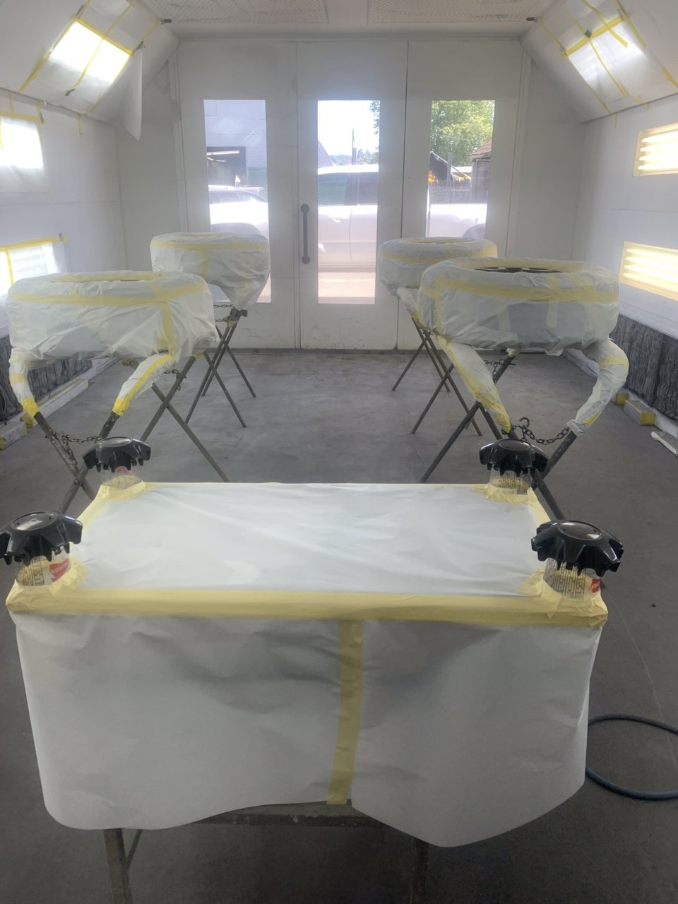

    Taped up ready to go

    If ya don’t mind explain the prep work on the wheel and paint type to do this where it will last?

    No problem. Clean wheels real good soap and water. Then prep with a gray scuff pad. Dull all areas to be painted real well. Re clean with wax and grease remover. A few times. Apply and epoxy primer 1 med wet coat. Then I used product called Imron by Axalta satin black. It’s a polyurethane activated industrial. Very durable product. Any other questions feel free to ask. Hope this helps
