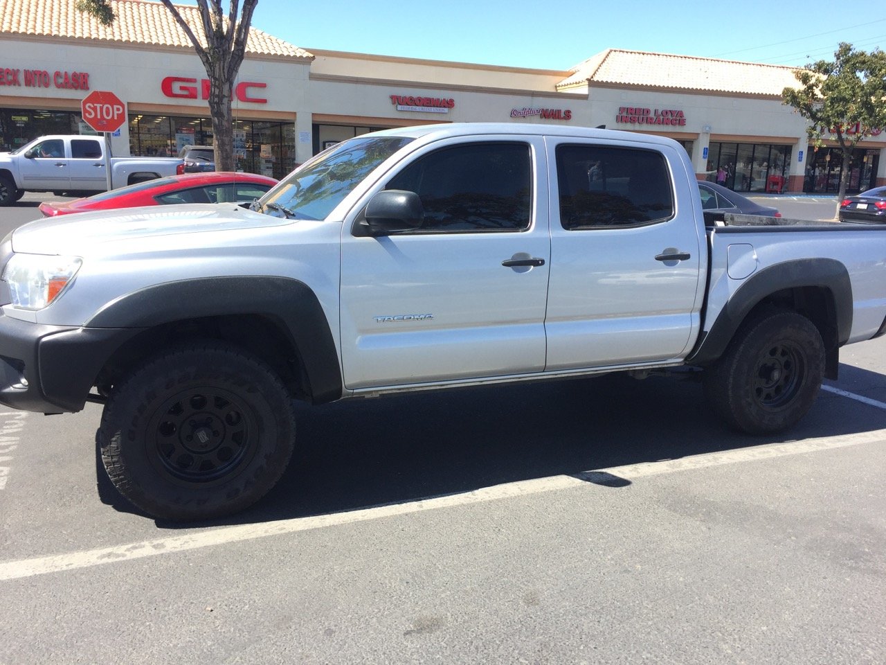

    Hello my name is Mario Sanchez I'm 19 years old I live in Lindsay California, I own a 2012 Toyota Tacoma Prerunner it's rear wheel drive and a 4 cylinder engine. I'm fairly new to off roading and modifying my truck. The only things I've done to my tacoma was put a pro comp body lift, toyo open country A/T tires and XD series rims. Everything else is just your regular stock tacoma. What I wanted to accomplish with my truck Is making it as off road worthy as possible, I know the limits on this truck especially with it being a 2wd and being a 4 cylinder. What would you guys recommend doing to it so its off road worthy. I just want to educate myself see what's the best route and not waste a ton of money on parts or stuff I don't need, and if you guys don't think I should do anything to it that's fine also Im just trying to see what's the best things to do. the first picture is what I started off with and the second one is where I'm at now.
