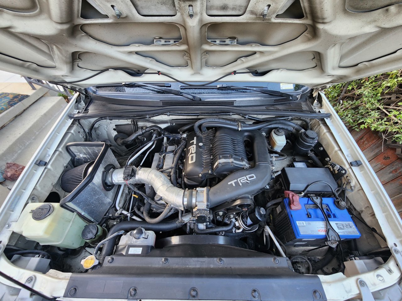

    I'm actually getting ready to walk out the door to go meet up with him! I'm also going to buy his gen 1 TRD intake so I can replace this heat soak waiting to happen:
    Thanks for the heads up!
