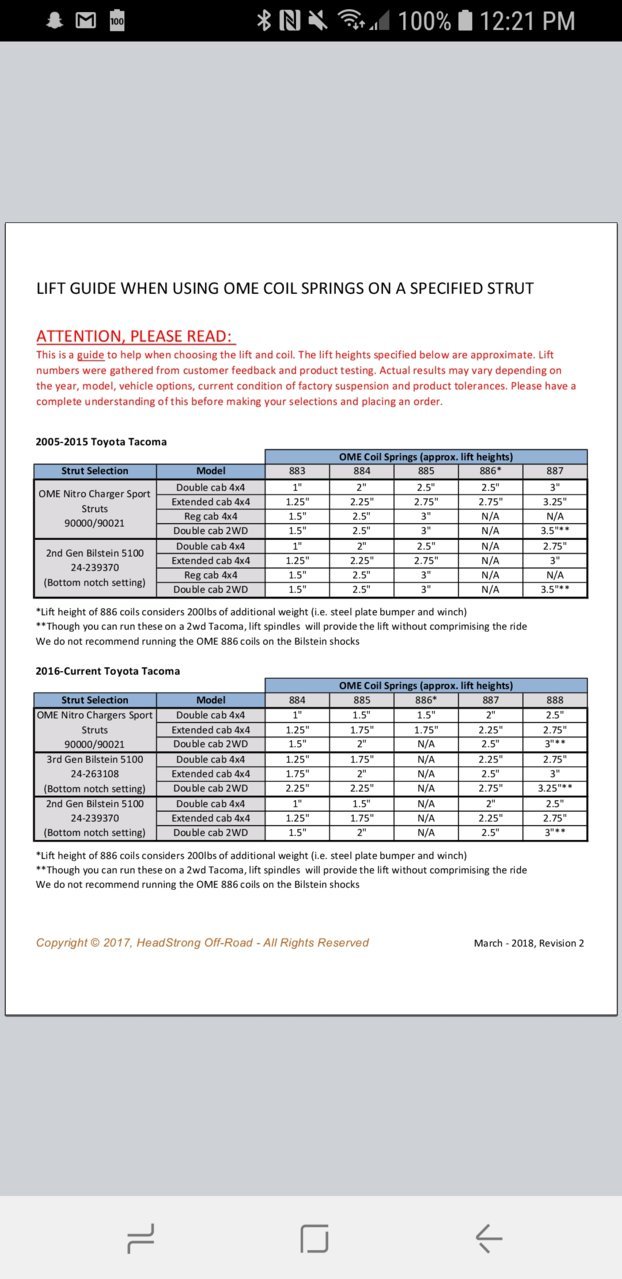

    At stock ride height your front I lower than front rear. So for my instance I only wanted to bring the front up enough to sit level with the rear. With bilstein 5100 with a factory coil set at 2.5" setting gave me the perfect 2" lift. Once you go over than then you'll need rear help. Your set up will really depend on if you want your truck to be lifted and sit level or lifted and keep the rake you have from factory.
    Edit: you'll probably need to stick with OME 883 or 884 for a new coil based on you not wanting to add armor weight. Here is a chart of which spring fits your needs and the lift achieved from each spring

    1. If you like the truck to look level, instead of raked, or god forbid, to have Bro-lean, and have the front of the truck higher than the rear.
    2. You measure the height difference between front and back, usually from the tire, to the wheel well, and go with options that gives you what you want, either some rake, level, or bro lean.
    3. I've heard different things, for the front, above 2.5-3" you'll probably need to replace UCAs, and/or coils, etc. in the rear, I've heard 1.5-2", and you may need to get a diff drop/Carrier bearing drop.
    My truck currently has 2" in front, ~1.75" lift in the rear, which gives it a slight rake, and I haven't needed any other parts besides the 5100s all around, and the AAL in the rear. No UCAs, LCAs, or Carrier Bearing/Diff drops and I have no vibrations or other issues related to lifting.

    I have a topper on and that ate up a couple hundred pounds of cargo capacity and more or less leveled the truck. I might eventually add a front bumper and/or some skids. I'd like to regain the rake and my cargo capacity.
    Based on that, looks like 885 or maybe 887 springs would be the way to go with whatever AAL in the rear to compensate (no bro lean desired). However, 887 springs would likely be too much right now so not sure if it's okay to plan ahead or if you have to work with what you have and modify as you go.
    Of course, with the 5100s I could use the stock springs. What are the pros/cons to doing that?

    If you're not planning on having any armor up front, you don't need any heavy duty coils. If you're planning on adding armor and/or winch in the future, wait until you add those to upgrade the coils, and stay with the stock coils until you put on the bumper winch.
    Since you have the topper on the back, maybe consider replacing the leaf pack with a medium or heavy duty Leaf pack instead of just the AAL. though a single AAL will add 200-400 lbs of carrying capacity in the back, and reduce/prevent some sag, and preserve the rake.

    So pros of keeping your fscotey spring on the 5100 is it's cheaper. That's honestly the only pro. The ride quality in my opinion improved with it as well. But since you are compressing the factory spring to achieve your lift then it's a bit stiff and reacts kind of quicker (hard to explain I guess). Which is also the con I would say. Ride quality would be better getting a 885 or 887 spring to achieve your lift. For your set up i would say just stay factory spring for now then if you dont like the ride you can upgrade to the 885. But if you know down the road you're gonna add weight I would rock the factory spring and save the 170 for later on springs.

    Thanks. Since I'll likely end up paying someone to do this (although someone semi-local offered to help) I wonder if the labor costs alone of changing springs later offsets just adding them now. Of course, I don't want to end up with a truck that drives like shit until I add some more weight up front. I may never go in for a winch anyway. Just one of those slimline bumpers and skids. Maybe 885 springs would be fine both now and later.

    If I raise the front 1.5-2" then I assume the rear needs to come up at least that much and ideally a bit more. Looking at this Dakar leaf pack sounds like I have to pick my optimal load. Problem is, it changes. The topper is constant and pretty much it when commuting, but when camping, etc. I have a few hundred more pounds of stuff and if I haul a trailer that's more weight. The normal 3-leaf pack says 300-600 lbs so that seems in the normal zone for me. Reasonable? Or am I missing something?

    Well one pro to getting the spring now is you can assemble the new strut and spring off the truck so there is no down time. Just swap the whole assembly and done. And I would honestly drop the 500-600 on a nice quality winch. Especially if you wheel yourself alot. Nothing worse than getting stuck somewhere without any self recovery. Also not a part you want to be cheap about. Because 9/10 times you need a winch it's your only way out and relying on a cheap one is sketchy.

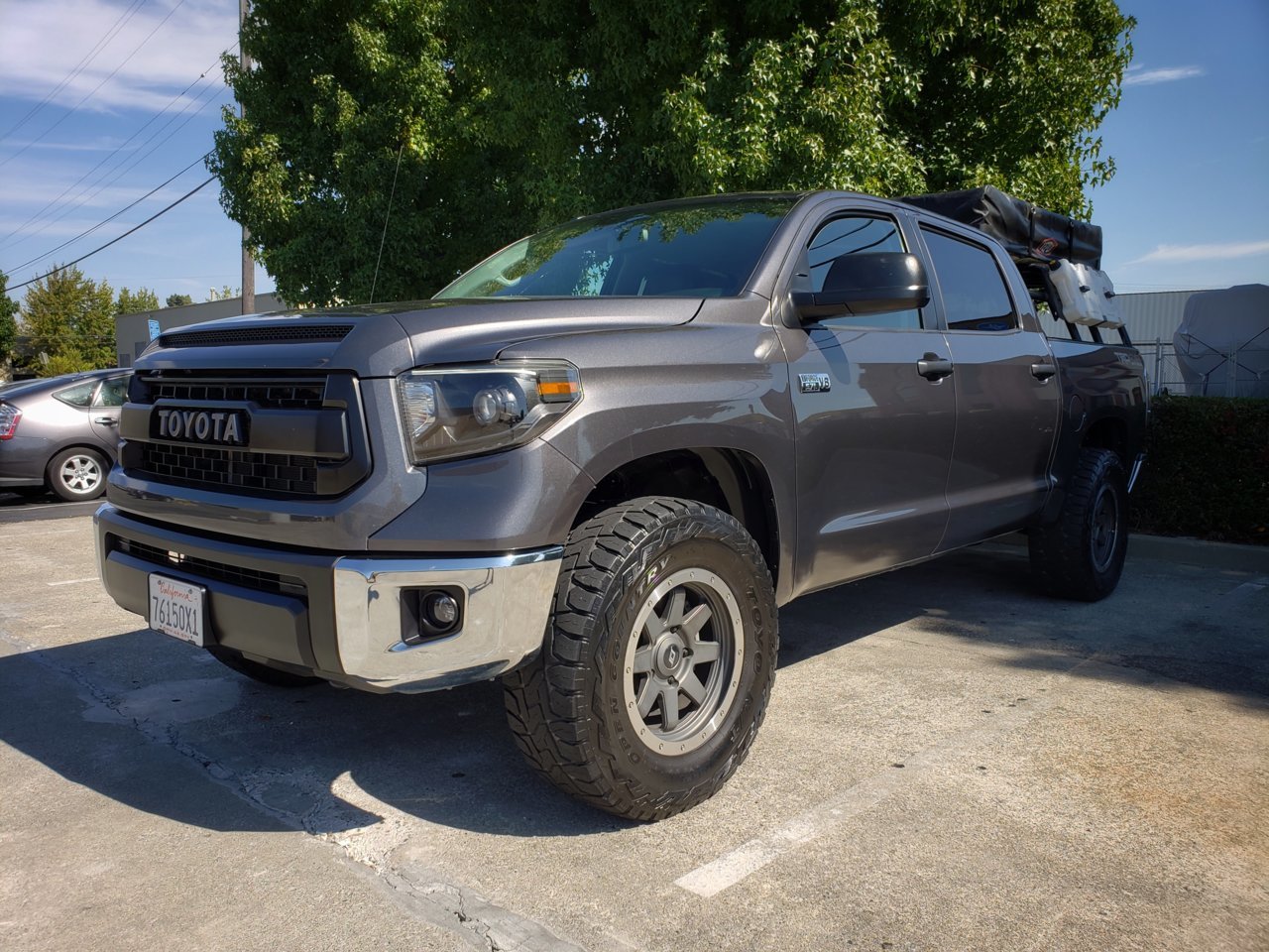

    02 Extra cab SAS Linked front and rear
    I lost track thousands of dollars ago.
    My DD for over 70,000 miles. Loved every mile of it!
    Until I didn't then I bought it's big brother.

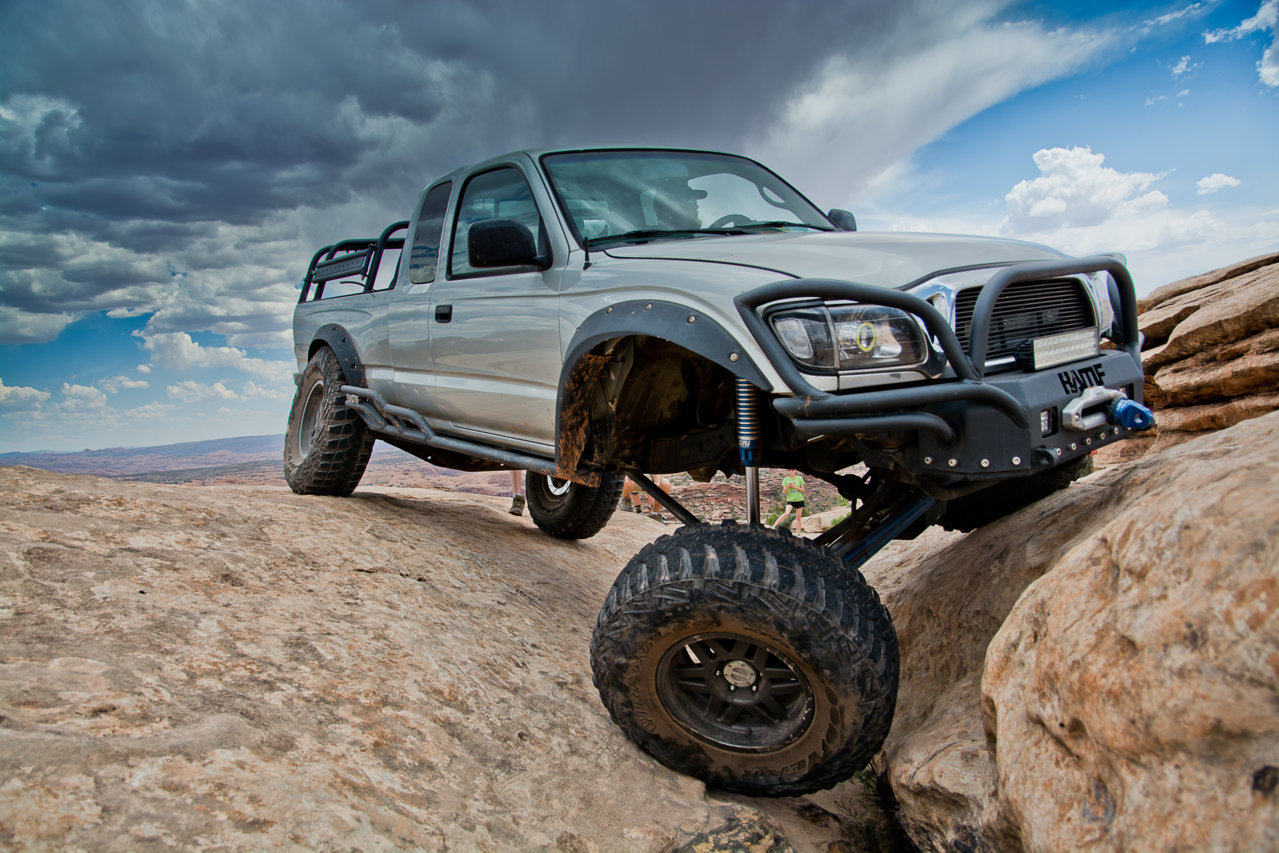

    All pro 3 link SAS kit, Diamond axle, kings on 37" MTR/K
    Mine is a DD! :D
    But i'm working from home right now :rofl:
    I used to drive this thing 40 miles everyday to get to work tho.
    I've never broken anything on the trails other than mangled skids, and a smashed tail light, but I have friends that blew up CVs or diffs and stuff and had to leave the truck on the trail to come back next day with parts to do repairs. Usually happens when you get stuck and start flooring it while truck starts bouncing around going from no traction to lots of traction. Just take it easy and stay calm. The trucks are pretty durable.
