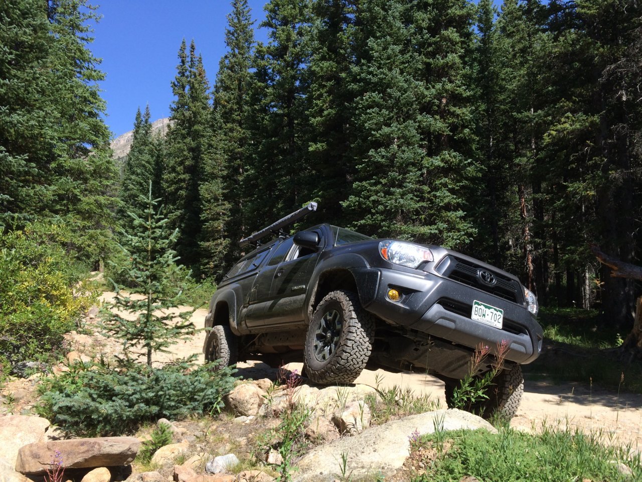

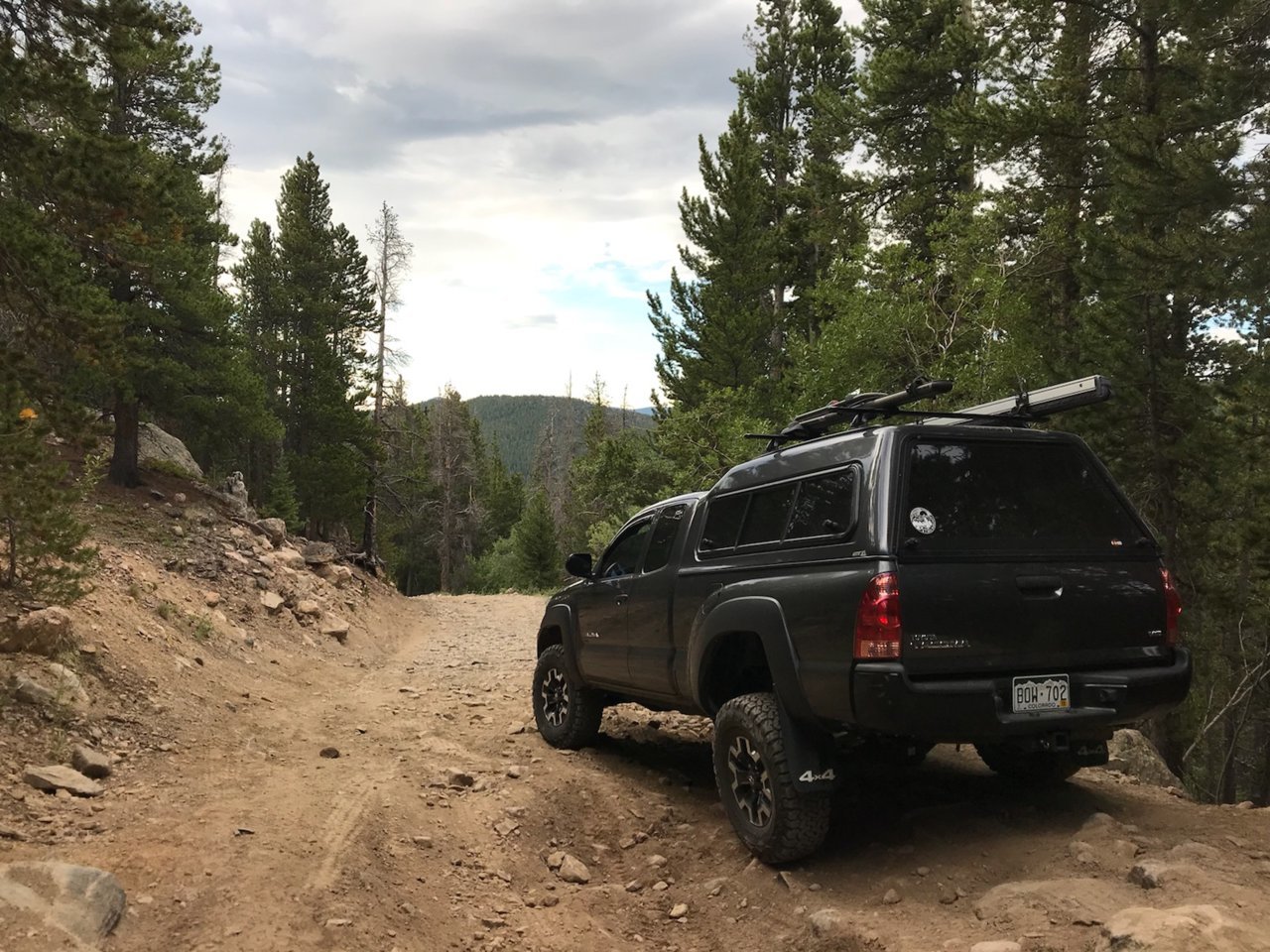

    My DD of 300+ highway miles a week in traffic, and my weekend offroad adventure vehicle.
    2.5" lift - Toytec coilovers, and aal in the rear. I need a full pack in the rear though, too much sag fully loaded. Research diff drops/CV boot rub. Did nothing to gas mileage.
    A/T Tires - 265/75/16 BFG KO2 E rated. These are what killed my gas mileage, from 22 to 19 avg.
    Armor - None. Sliders and front IFS skid ordered, and can't wait to get them on.
    Recovery Gear - Straps, shackles, tools, compressor, shovel, first aid, etc. I'm constantly adding to this. Hi-lift and boards are next on the list.
    I probably won't go much further than this with a build, as I'm usually by myself so I don't want to get in too much trouble. Get's me to work reliably and looking good, and I haven't gotten it stuck yet so I'm still within the limits of the truck and my driving ability.
