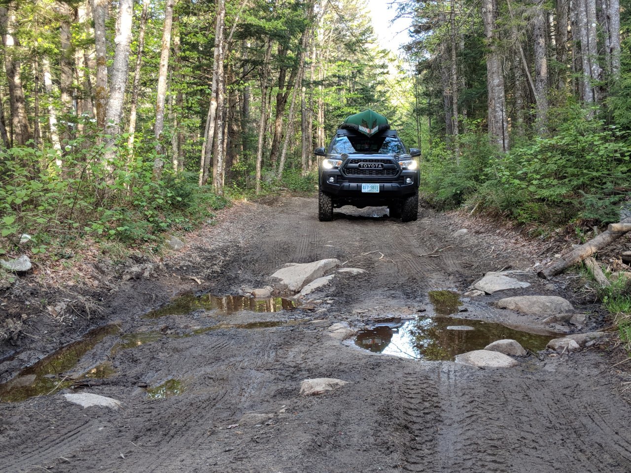

    That second pic is pretty similar to some of the roads I've been on. Basically, they have A LOT of rocks but they aren't overly huge rocks. Occasionally one is too big and I can usually go around it. Stock height, however, is low enough that I've come down on the frame a few times. Skids sound like a good idea as well as 2".

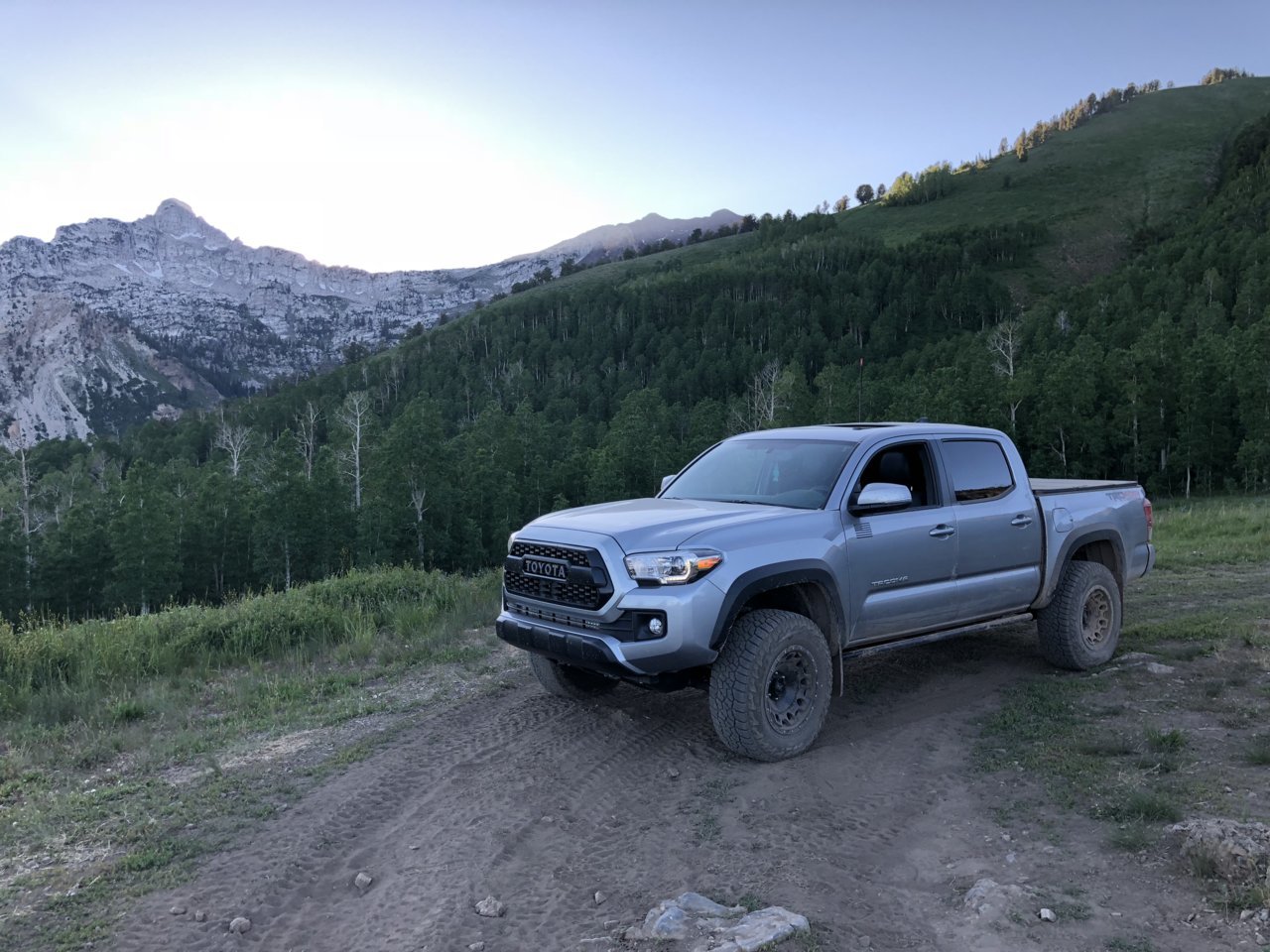

    I recommend that you look into getting new, bigger tires. You'll gain a little bit of clearance this way and have better performance off road.
    If you want to lift it, you can get 5100s as others have mentioned. I would recommend doing 885 coils or 887 coils depending how much you want to lift. In the rear, get a block or AAL to keep it level.
    I got sliders on my truck, with no under armor yet as I haven't felt the need for it.
    For reference, here is my truck on 5100s (all 4 corners) with 885 coils and a 1" block in the rear. Tires are 265/70/17.
