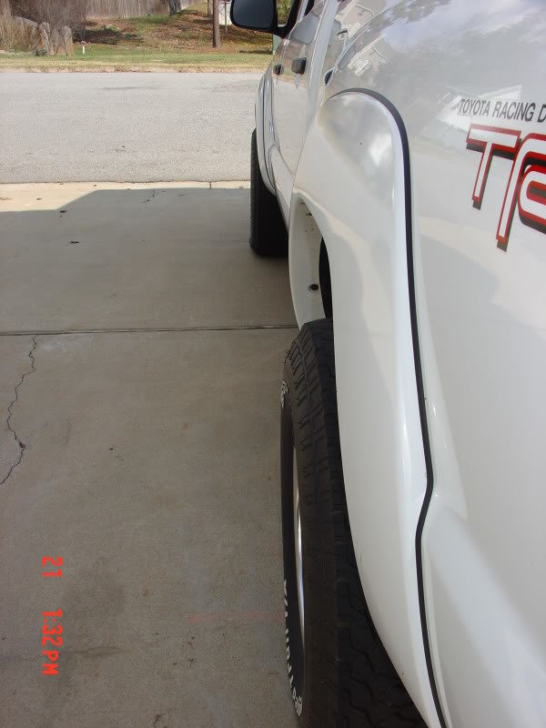

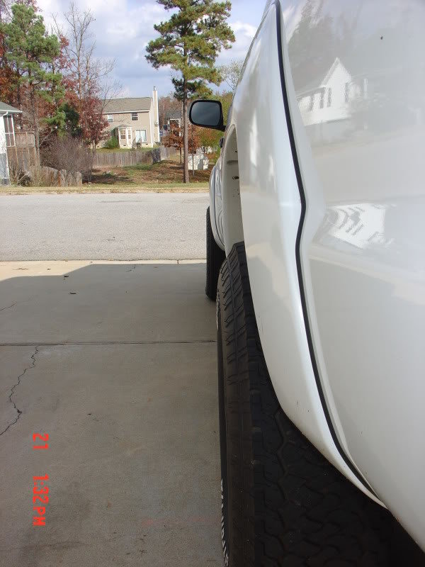

    I'm not sure but it appears that my wheels stick out a little further than other Tacomas I've seen with stock wheels....check my pics & let me know what you guys think?
    So I'm wondering if I will need a .5" spacer when I upsize to a 285/75/16 later??

    There should be some stamping on the wheel, something like "16x8jj ET0" or something like that. If you post it we can decode the offset/backspacing measurements. The stamping may be on the back of the rim.

    No, you will not need a wheel spacer to run 285's on the Ivan Stewart's. Info is as follows:
    Ivan Stewart: 16x8, +1 offset, 4.5" BS
    To remove any doubt, check out this link and read the OP's comments in post's #9 and #13. I've seen the truck in person and the tires cleared the UCA's easily: http://www.tacomaworld.com/forum/su...t-installed-questions-stance.html#post3761735

    But you will still rub with 285's. I have the exact wheels and 285's and did require trimming. If your not wheeling hard then you dont need to trim much but if you expect to wheel you will need to trim a bit and I would even recommend you do a cab mount chop!
