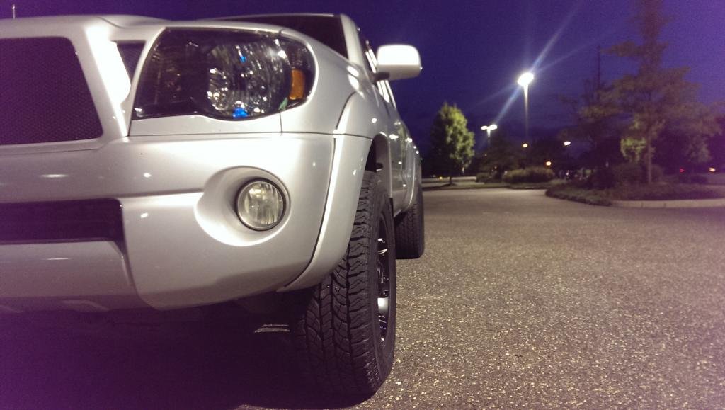

    I would say a +14 offset would do the trick
    Try and find a 8" or 8.5" wide rim that you like
    Here is my 05 pre runner with a 8.5" wide rim with a +14 offset
    Also whats your stock wheel specs?
