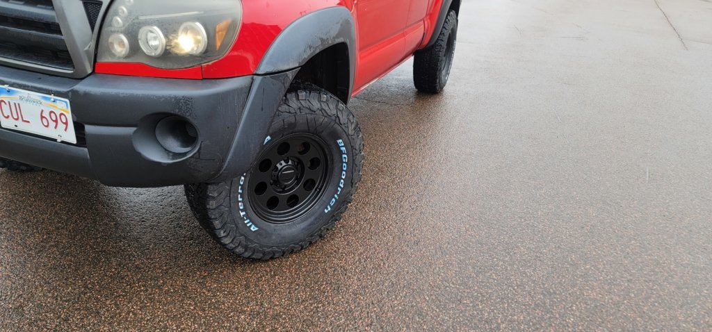

    Bumping an old thread, but figured people might want to see another option.
    Pro Comp PA 201 Heritage 16x8, 0mm offset, 4.5" bs fit well. I've got 285/65R18 KO2s installed and the only contact point is on the front bumper.
    More pictures on my profile, I'll add some more when I get a chance to chop off the excess.
