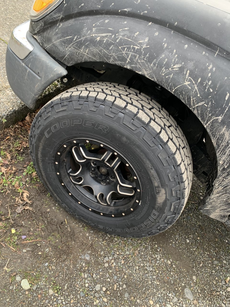

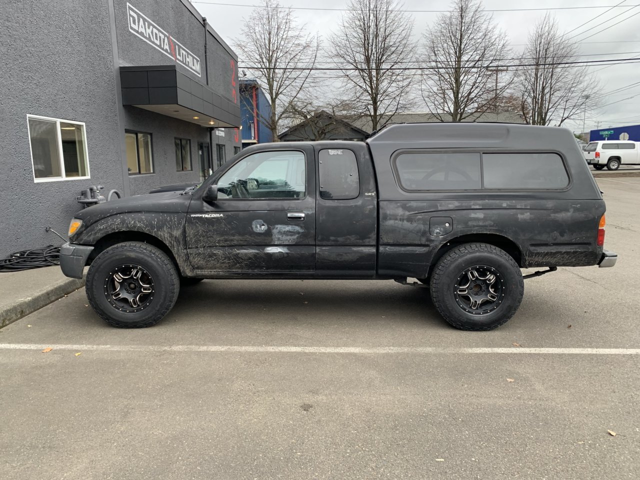

    Nope, no spacers. Got pro comp 69 rims 15’ with 3.75 backspace. No idea why i have so much poke
    The fabtech spindles said maximum backspace of 3.75. I am slightly confused. This means dont go over 3.75 right? As in 3.75 is the deepest. 4 too much and anything less than 3.75 is good?
    only reason i got these rims is fb marketplace had a set of 4 for 150$

    So is it minimum 3 3/4 or max? As far as backspacing goes 4 would push the tires further away from the suspension bits? 4 would have more tire poke than 3 3/4?
    i saw the 4 in BS guy. Thats why im confused if it said 3 3/4 max.

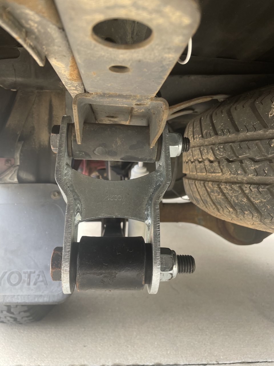

    Can you take a picture of the shackles? I'm curious if the have the same bend profile as the stock ones

    Finally got new tires! Cooper AT3s in 235/85r16. No rub with 3” Fabtech spindles and aal + pinch weld mod.
    193F7136-91CF-4A9E-AC5C-212EDD07F868.jpg 86EB01D9-B930-4E14-94F4-2F19FBBC9819.jpg
    z_thompsonpa and Das it mang like this.

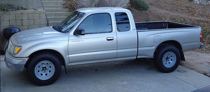

    My old cheapie tires were nearly bald, one of them picked up a nail last week, and there's a storm coming in tomorrow so I put the new shoes on with no lift for the time being.
    235/75R15 Coopers on 15x7" Cragar Soft 8s with 4" backspacing.
