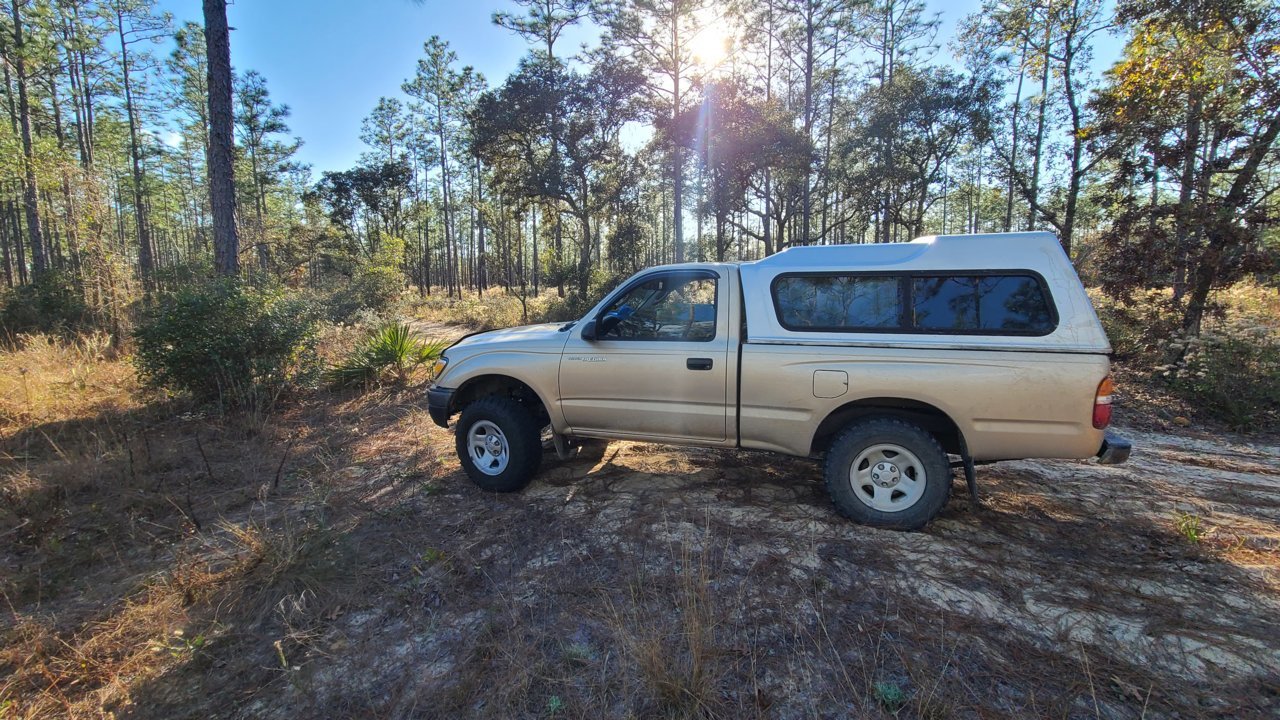

    Taco-post1.jpg aye guys,
    so i just did the fabtec spindles, daystar isolators new upper arms( oem moog) new lower ball joints, new outer tie rods, and new kyb shocks in the front, for the rear just did and AAL and new 5125.
    my question is does anyone have balljoint binding issues? I get a popping noise when i turn lock to lock from a dead stop or if backing out of a spot. the balljoint angles doesn't look to bad compared to the factory location. ive had it aligned since doing all the work. it drive straight no weird camber or caster. Just wondering if anyone encounter this issue.

    the tires are some 29s they defiantly give me enough room to not worry about hitting the tire on any of the inner fender. i believe Accelra MT01. cheap wallyword tire but i paid $200 for rims and tires so was a deal
    yea seems like my issue might just be something i broke or bent fuckin around in the woods.
    so the 5125 maybe gave it a little bit of a lift since my factory rear shocks where completely blown. i did go with the 33-185606 for the rears since i have the topper. I chose the KYB for the front since I do place to ether find some Doetsch UCA or make something similar to the Downey Mid travel kit thats been DC long ago. ive also been eyeing those OME 2881 springs @MagnumHelms did a write up on as a cheaper less headache option for a little more lift. I don't notice any difference with the miss match. i didn't choose the direct fit for the KYB i believe i found a set that used the same mounting but came off a 70s dodge dart or something mawybe a 240D MB. it was almost near identical with Ext-Comp measurement.Just the extended was about .78 of an inch longer, and the valving was stiffer. again the price point being the biggest factor $70 for both front vs $98 for one side. that im eventually going to rip out.
    for activities I can usually cruise the dirt road in ONF (Ocala National Forest) around 50mph. Hands the OTBP trails quite well clears logs and other small obstacles with no struggle Ive also " jumped " some train tracks nothing crazy just life an inch or 2 off the ground. which may be the issue of the noise. it does quite well although the diff is needed since i did get stuck high siding my rear axle in the mud during xmas.

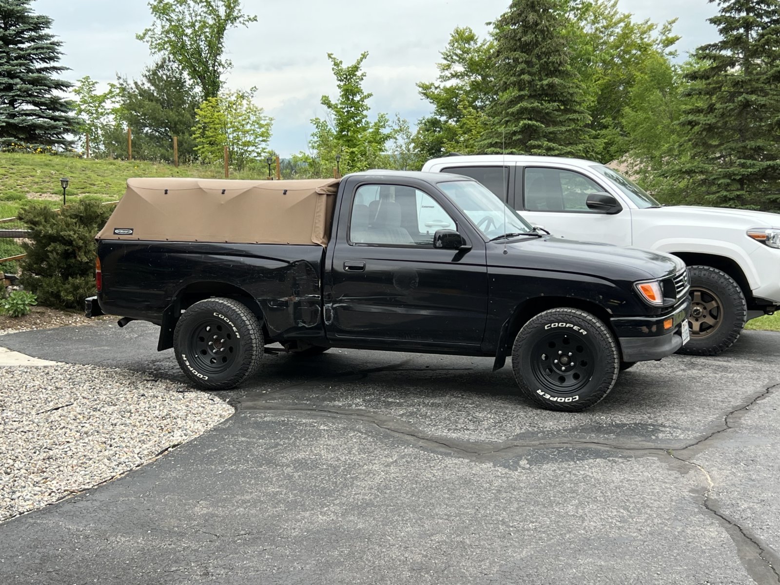

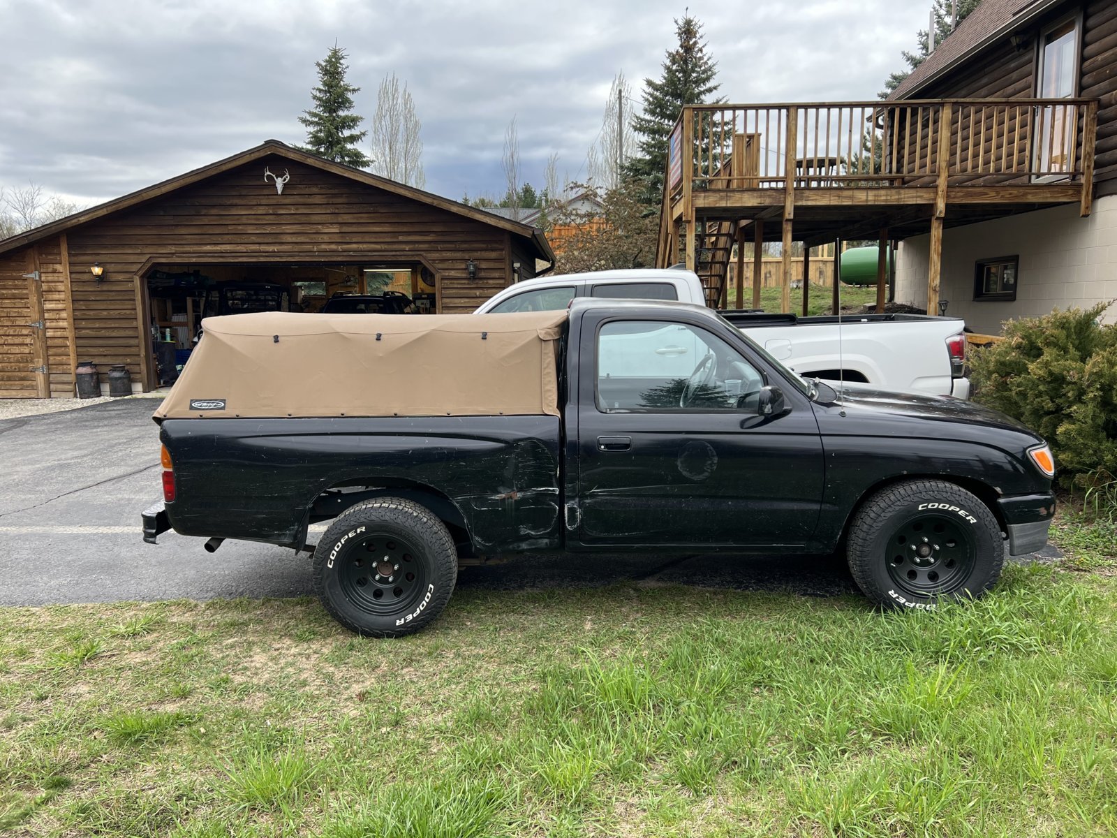

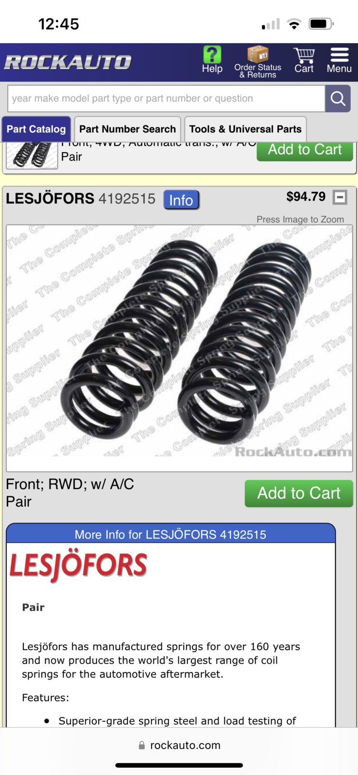

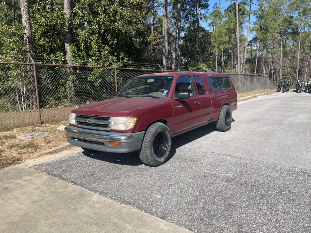

    As many have mentioned it looks like the Moog v6 coils are discontinued. I found some Lesjofors spring on rock auto that appear to be for a rwd, but wondering if these are prerunner. It’s been covered but somewhat unclear to me if the 6lug (4wd or prerunner) coils work to add as a replacement for the front springs for a 5lug mini. Also some reports that the OME 2880/2881 springs work too. It seems that some people have installed them successfully but others indicate “suspension setups are totally different on 4wd and won’t work”.
    I believe that a 5lug v6 is the coil I’m looking for, and that the prerunner v6 coils are different?
    I don’t really want lift spindles due to the wide trac, I already have some wheels that add poke and don’t want that to be exacerbated by the spindles.
    I’m hoping to add coils and coil spacers for about a 2” lift

    4192515 looks like the best candidate for a pre-2001 5-lug V6. I put 4192516 coils on my '04 which are listed for '01-04 5-lug V6s.

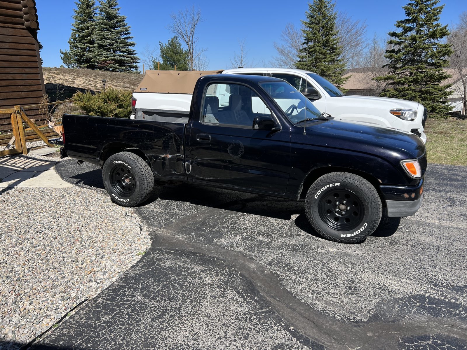

    Alright so update, Lesjofors 4192515 fit in my 1996. Had to use a combination of pry bars and spring compressors. First side about 2 hours and second side about 30 mins. I removed the knuckle and left the upper and lower arms on during install. I didn’t take measurements before like an idiot but here are a couple before and after photos. I would say at least 1.5” with the sagging old springs (230k).IMG_5339.jpg
    after
