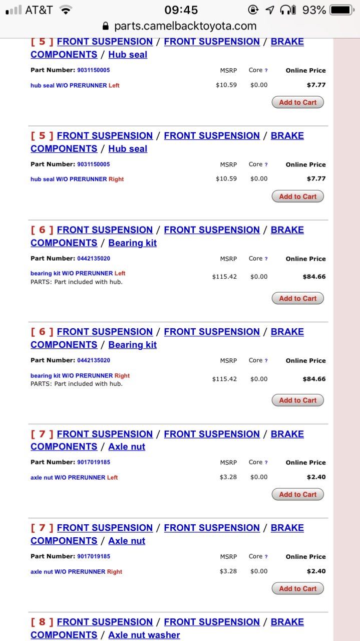

    Anyone have a part number for wheel bearing for a 2004 5 lug?

    Here you are

    This is the whole hub assembly right? So I wouldn’t need to press out the old ones?

    (6) is bearing kit, so the outer rings and front and rear bearring

    I got mine at Autozone, the Duralast branded box. I am pretty sure they were Timkens inside, though. Autozone Part Numbers are SET3 and SET5.

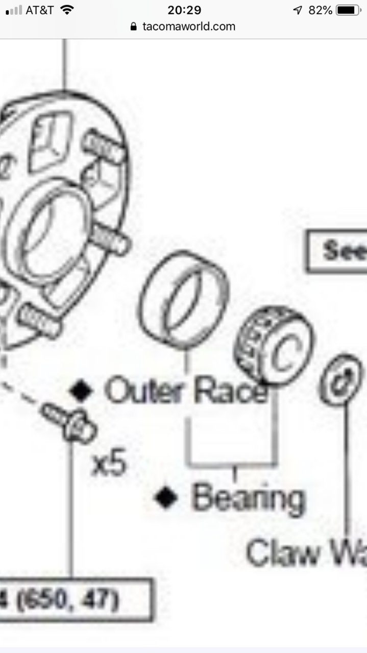

    You need a press to get the outer ring out

    The ring is pressed into the hub itself. The bearing comes out but not the ring

    oh nvm... i think you mean the seal. I did not attempt replacing that.

    No the outer race.
    That part the bearing rides on

    Okay, yeah I just left the old races, too. I bet mine would be a bitch to press out.

    If the race wears un even then you will still have wobble even with new bearings
