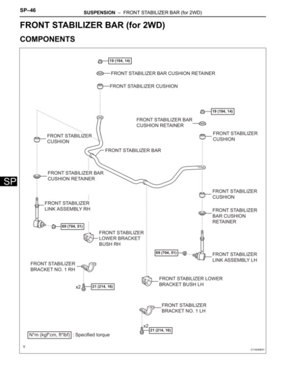

    What are the stabilizer bar brackets supposed to be torqued to? And if it’s easily accessible what do I torque the end link bolts to?
    I found torque spec on another thread here for stabilizer bar “side,” and idk what that is. And then there is also a torque spec of 66lb for the end link but doesn’t specify wether it’s 4wd or 2wd. Any help would be appreciated. When I have a few more bucks I’m going to buy the repair manual.

    I believe its 22ftlb on a 5lug. For some reason everything on a 5lug is tourqe very low.

    Here found you the actual guide
