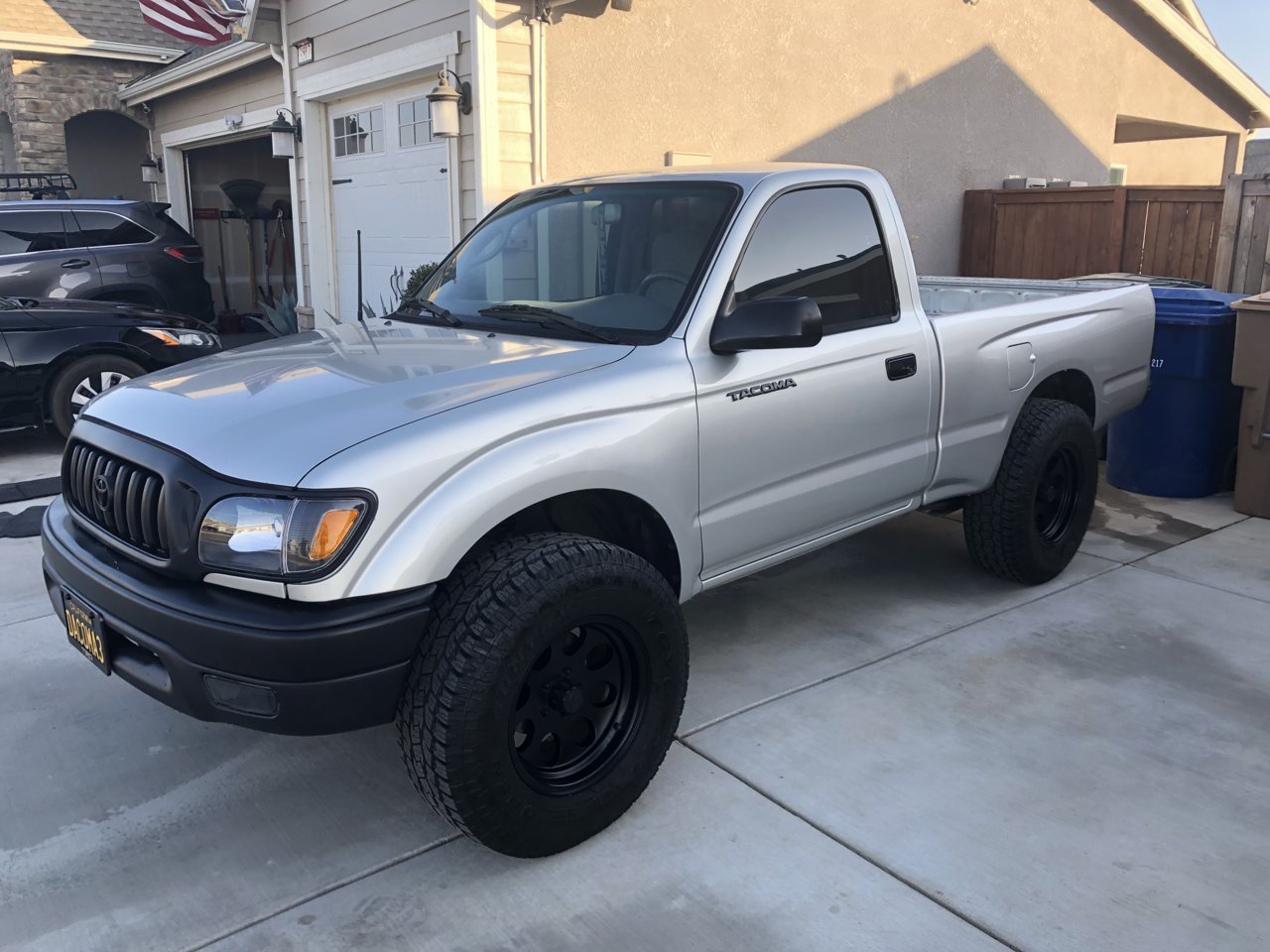

    Long time stalker first time poster. Just joined the club today actually. Here is my current ‘03 5 lugger build w/
    Fabtech 3” spindle lift kit
    265/70R/16
    Before:

    Ill add to this these thread, here is my 03 Tacoma. I am running 31" tires, Fabtech ultimate lift, spindles, bilstien front shocks, and i just added icon rear leaf expansion pack. I bought it for my 2019 tacoma but it actually fit my 03 mini 5 lug. the fabtech add a leaf was really hard on the bumps so i removed it. I would say the ride quality is pretty good, I have a rear aussie locker in the back that i may remove pretty soon and just add a elocker. the 6 lug locking prerunner diffs will work for these trucks as well. they are spring under i believe so you need the leaf brackets i would pretty do that"rather then the aussie or lunch box lockers. they are annoying when turning, click click dsfsdjfdsfs click.
