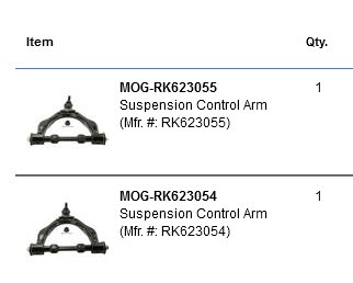

    with 200K miles and more importantly 22 year old rubber, you could probably stand to replace the control arm bushings too. the 2 MOOG upper control arms below come with upper ball joints. Lower control arms do NOT come with ball joints.
    RK620354
    RK623055
    The rest of the parts you need should be below. I'm pretty sure the parts are the same for all 5 lug suspension regardless of cab or engine/transmission (with the exception of the springs. They differ 4 cyl vs 6 cyl). These are all MOOG parts. Do NOT pay attention to what Amazon tells you. They will tell you they do not fit your 5 lug truck.

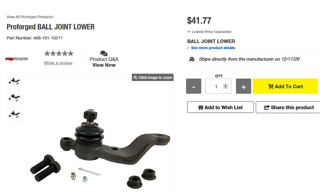

    You made this stupid proof, which is exactly what I need haha.Im looking to find another site to order the PF ones from before I stick to the listed Moog set, but Im coming up short. I have the list you gave in a cart ready to go, just waiting to see if I can find an alternative source for the PF set.
    @z_thompsonpa
    I just looked on Rockauto.com and it looks like they have the pro forged lbj for one side and not the other just like you said :/

    unless you get lucky and find someone that has the PF one in stock (I didn't find anyone that did), you might have to wait a while. The note below on Summit looks like it drop ships from the manufacturer and won't ship until beginning of January.
    Edit: Looks like Jegs may ship sooner
