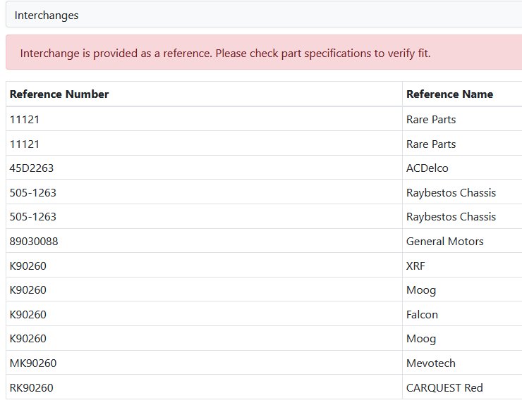

    those look like the right part numbers. I got no shame in buying stuff from Walmart! I've actually been buying from them quite a bit over the past few months (not automotive related but still) and have been very happy with them.
    Looks like Amazon has them for $76/pc so that's $304, a few bucks cheaper than Wally World.

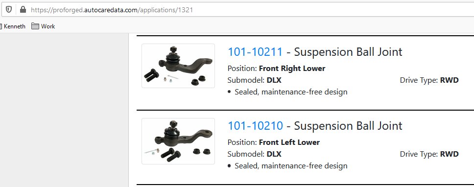

    best bet is to cross check whatever you find on Amazon (or Walmart or anywhere on the internet) to the actual manufacturers website because they are more likely to have them listed correctly for your vehicle. See below from Proforged's website.

    Wow, the proforged site is pretty awesome. It actually gives the part numbers for other manufacturers too for reference.

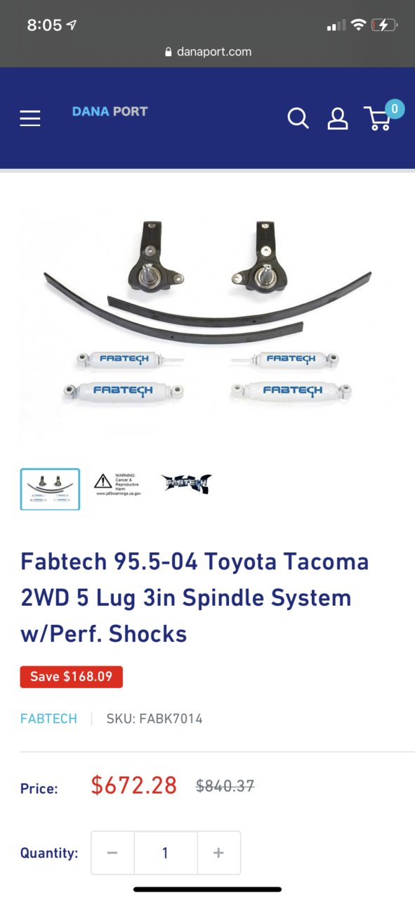

    I have a 2002 5 lug taco that i want to lift...is this a legit lift i can get?

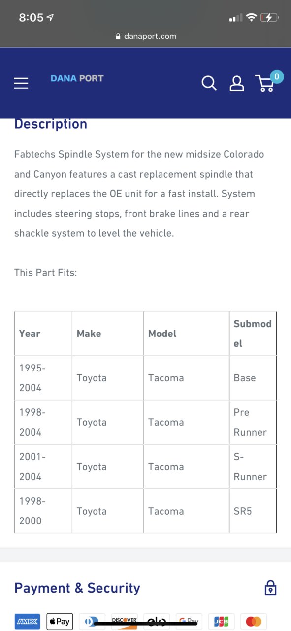

    Are you able to use the stock 1999 2.4L wheels with FabTech spindles? I love the look of steelies and would save me from buying a set

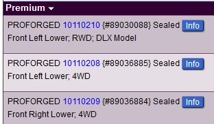

    dasitmane420
    dasitmane420 Member
    Jun 22, 2021
    #369299
    10
    fixed front right lower in bold. otherwise perfect!
