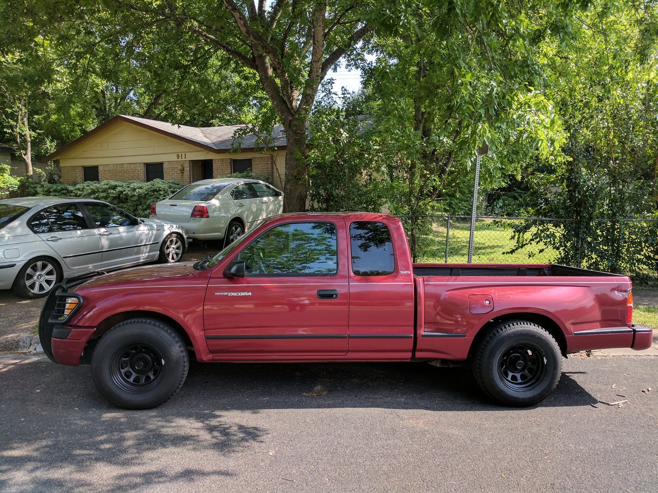

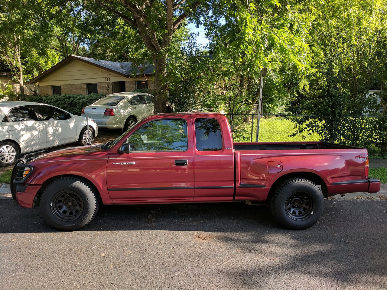

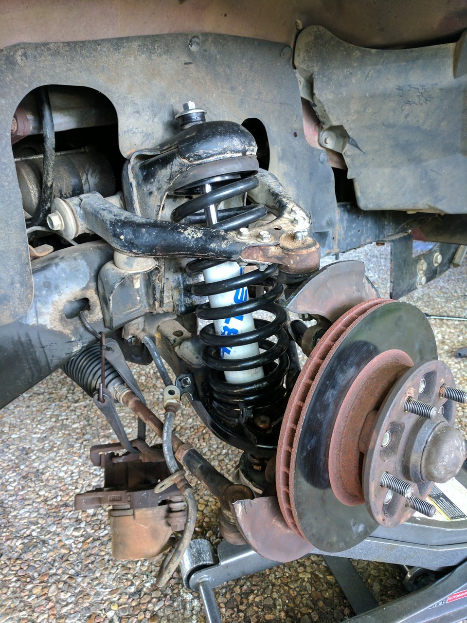

    Daystar spacer lift and new shocks - Before and After with 235-75r15 15x8 4in BS. The driver side (shown) is the prerunner fender. The passenger side is not shown bc it was smashed in both photos... lol

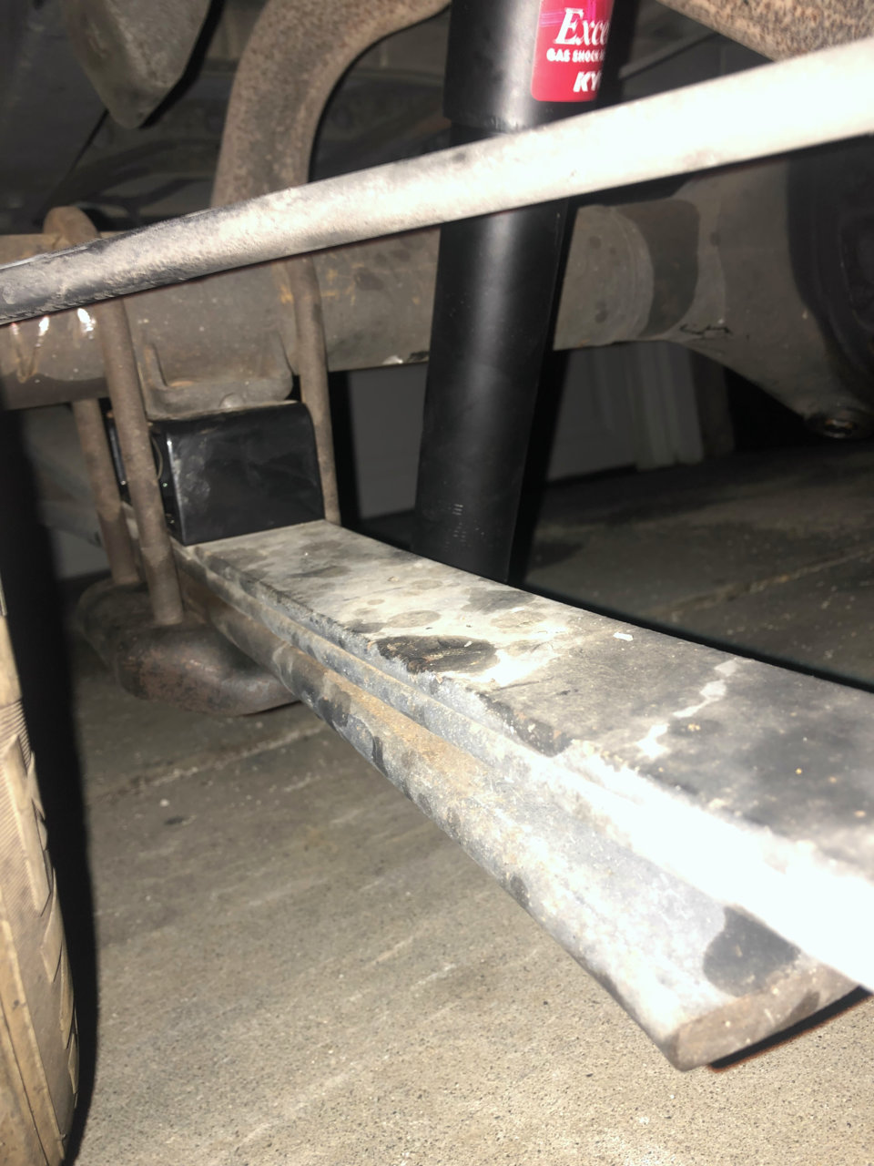

    I'm adding a lift to my 2000 Tacoma 5lug xtracab and when I got the extra 2inch spacer, I found that the stock U bolts aren't long enough to accommodate the additional spacer. As you guys probably know the U bolts go over the diff/axle housing as opposed to over the leaf springs because on this model the leaf springs rest below the diff.
    My question is where do I buy extra long U bolts that can accommodate the additional lift/spacer?
    Not the U bolts that go over the Leaf springs but extra-long U bolts that would go over the diff.
    In the picture, I'm going to add an extra spacer block on top of the original, which is why I need longer U bolts

    If you want to lift the truck you can just remove that spacer. It’s a lowering block so removing it would actually lift your truck. If you try to add another block on top of it, you’ll just be lowering your truck more and make your suspension ride like shit.

    Lift blocks lift trucks with leaf springs mounted over the axle. 5 lugs have leaf springs under the axle and putting lift blocks on will actually lower the truck.
    As far as U bolts you get them from ruffstuff kartek Deaver. I've seen some at pepboys and napa

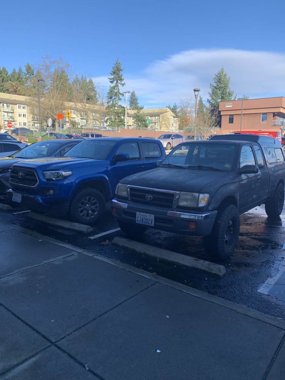

    35A86977-D436-4726-A9D7-E6446CFE9B6C.jpg 36F56576-EE19-421A-AE0F-0934FAD228D6.jpg

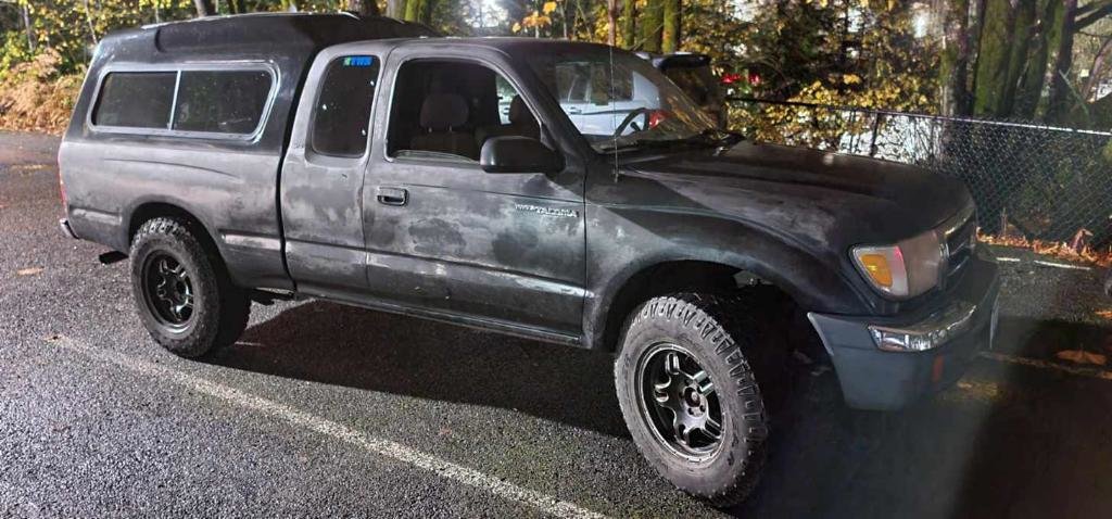

    Just finished my Fabtech spindle lift. Looks pretty great now! Anyone in the Seattle area should check out Stew’s Garage in Kirkland, it’s a “be your own mechanic” shop with all of the tools and toys, so cool.
    The tires are 235/85/r16 wranglers. They are used and a bit worn, but fit pretty well with minimal rubbing only at full lock.
    Like an idiot I tried the fat bobs spacer and aal lift first(which was a fucking nightmare to install with basic tools) and immediately took the spacers back out and ordered the spindles. They just didn’t offer as much height as I wanted. I also did Fabtech shocks on all four corners.
    I’m about to get some new tires on it and get an alignment. Gonna get some open country at3s.
    One question, what size tire will fit on the spare mount?

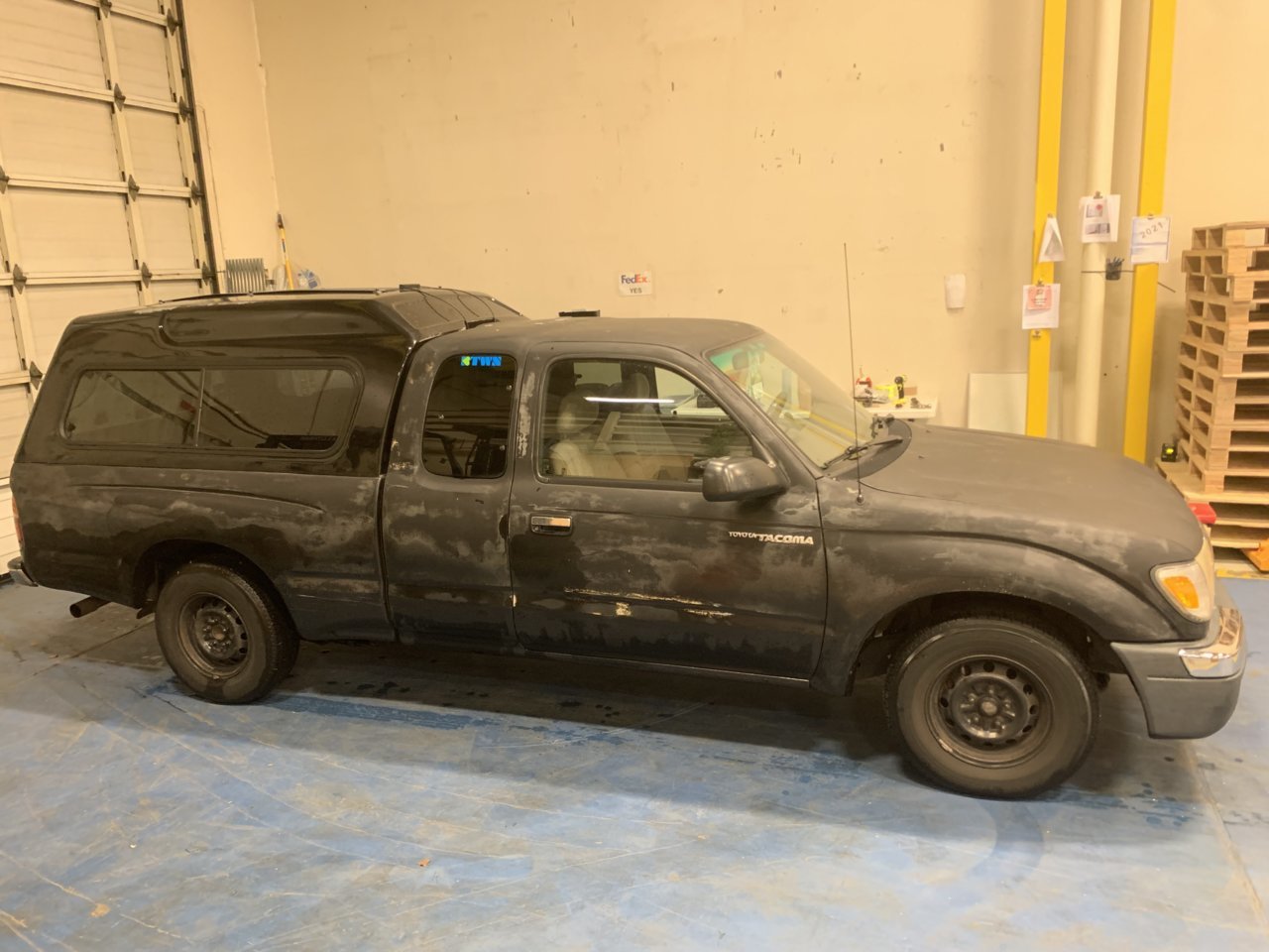

    oh, and here’s a before picture:
    z_thompsonpa and Das it mang like this.

    I might go a smidge smaller with the at3s. I’m thinking/hoping if I go a tiny bit narrower I can keep the total height, about 30.5” and reduce rubbing without more modifications like cutting.
    As is the rubbing is minimal and I don’t want to reduce the height gained through the huge tires.
    I did keep the aal in, it did a great job creating the height I wanted in the back.
    Here it is next to a 3rd gen 4x4(stock I think?), the ride height/ground clearance is nearly identical!

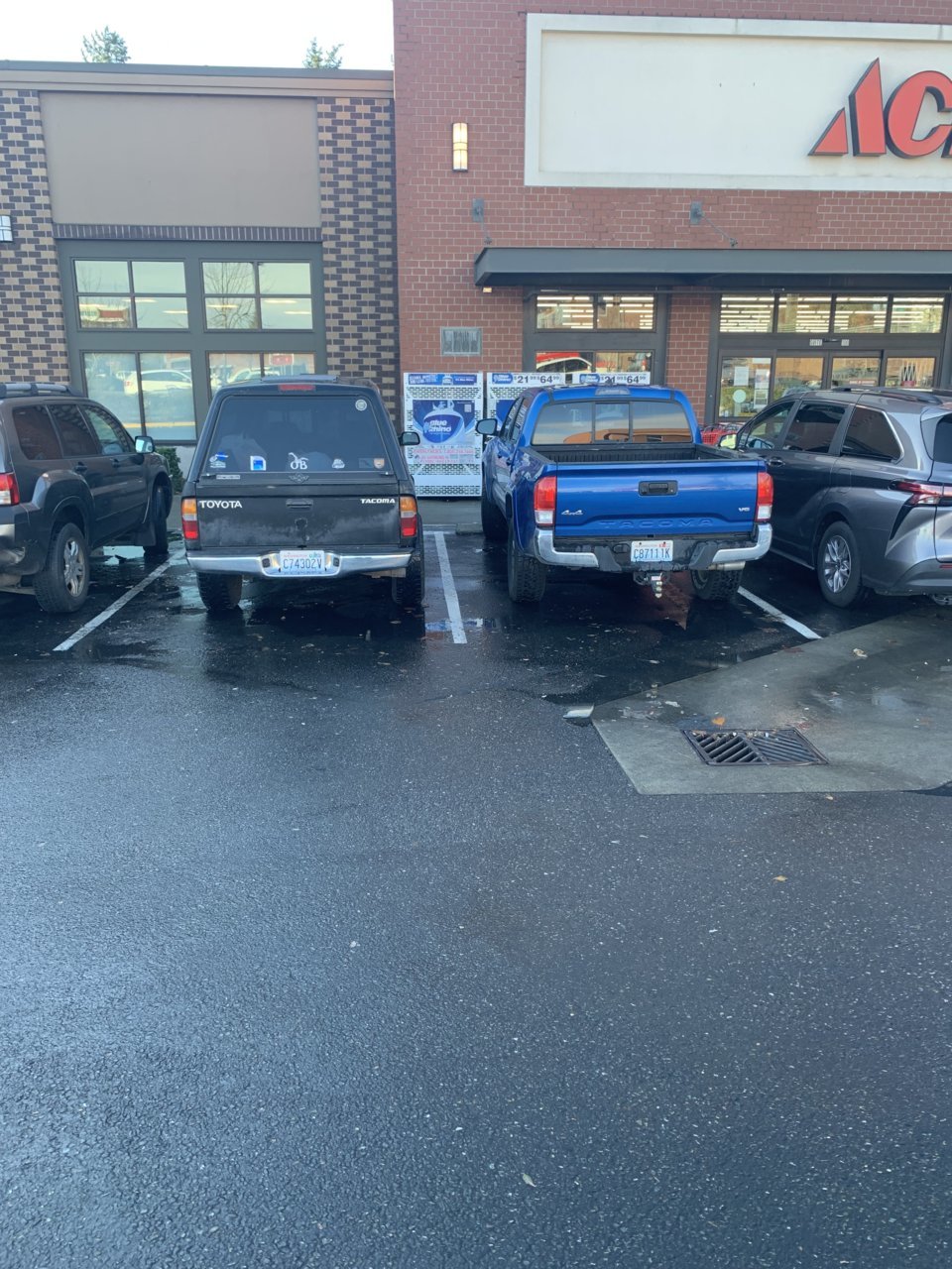

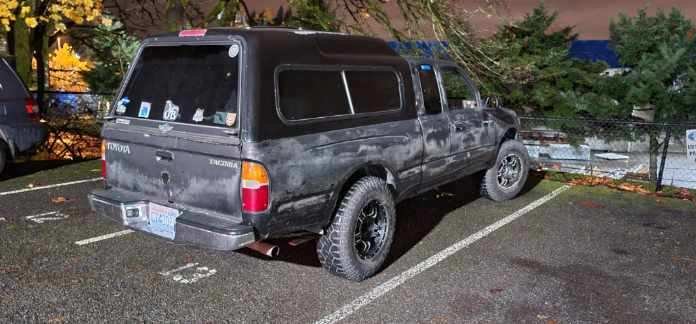

    246FF467-228D-4735-B6BD-657A371D2500.jpg 2BC54E90-0EDE-4722-917E-D3A050DABCAF.jpg
