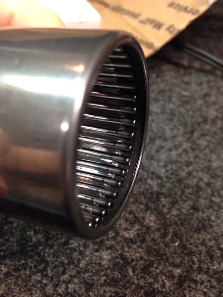

  14. Dec 22, 2014 at 6:00 PM
    #2054
    Evenflow
    Evenflow Well-Known Member
    Jul 15, 2013
    #108344
    5,774
    Jason
    San Diego, CA
    06' DCSB 4x4
    Yes
    Just got through replacing mine and there was clearly visible wear on the needle bearings ( dark line across needles in photos ) and wear on the edges of the race in between every bearing visible as the shiny wear spot on the race
