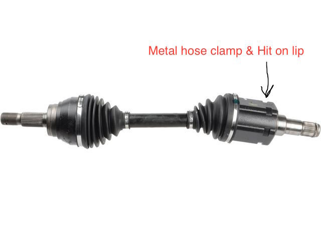

    What technique did you use for removing the axle?
    The first time I removed one I used a prybar and completely messed up the metal flange on the cv. The one that butts against the seal (was replacing it anyhow), so I used the steel cable sling/ sledge hammer the second time around. It was still a pain.
    Trying

    See Attached..
    I put a 5" metal hose clamp around the pointed out area just tight enough to get my 3 ft screw driver/flat pry bar in but tight enough to not let it slip off the lip that i was hitting against (Had my buddy hold the axel so it didn't fall). I started hitting the screw driver/pry bar with a rubber/plastic mallet and it didn't have enough shock value to release it from the Diff. So I used a regular 16 oz hammer and it came out in 4 good hits. Hope this helps
