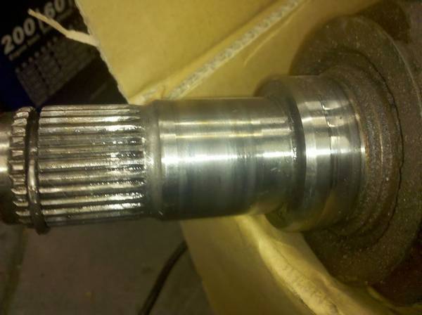

    Mine eventually blew the axle seal. I drove for 40k miles with it because the first dealership denied there was an issue. The second dealership 40k miles later saw the leak, broke it down and found both the outer and inner bearings were ground flat where the axle wore in. They were concerned about metal shavings being inside the front diff so after weeks of dealing with Extra Care, they gave me a whole new front end.
    Yes, it could damage your differential, EVENTUALLY. You're fine to drive on it for awhile, unless it feels really bad.

    Heres what mine looked like, its hard to tell though...

    doesn't look too bad, the bearing surface by the splines looks a little worn but i see no damage to anything.

    Like I said, hard to tell in the pic, but the bearing was seized and consequently wearing down the bottom side of the race/needles
