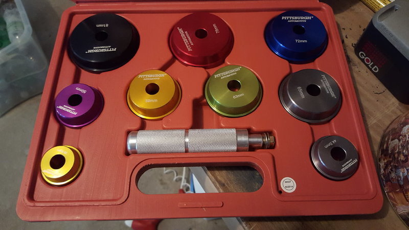

    I have the driver to lend out as well. But it is in mm's does anyone know which driver it is

    Here are the drivers I don't know if anyone has used them. But if someone knows which color or mm I will send it with the tool when I lend it out

    Figured it out, so boxed up and ready to go out to @ Muy Grande

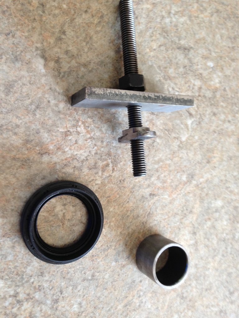

    Done, it felt like it took me forever to drive the ECGS bushing in, but now everything is smooth as butter. :anonymous:Only problem I had was I split the outer part of the new seal when installing it with the driver tool. I should have just used a 2" coupling like some one else suggested. There are no leeks but I still ordered a new seal I may change it out when I change the front brakes.

    doing mine this weekend, i have my own installer im pretty sure, id be willing to pass the remover along if need be too. so once im done with it (idealy saturday) ill lend mine out also. just the puller. if i have the correct installer, i may do that as well. LMK!

    Well I did my bushing tonight and it is as straight forward as it looks! Problem seems to be solved SFSG!
    I would like to participate in the tool loaning if anyone needs it. 60$ was pretty rough to swallow but it is what it is. For the life of me I can't find my race installer, so I used a 1 1/4 half inch drive socket and an extension. Worked fine. I also have an axle seal I didn't need. I'd be willing to sell that for what I paid for it through ECGS shipped. Pm me for either. The install tool looks to be like pay shipping both ways?
    LMK! Thanks for all the help!!

    I have the remover RTG if anyone needs it.
