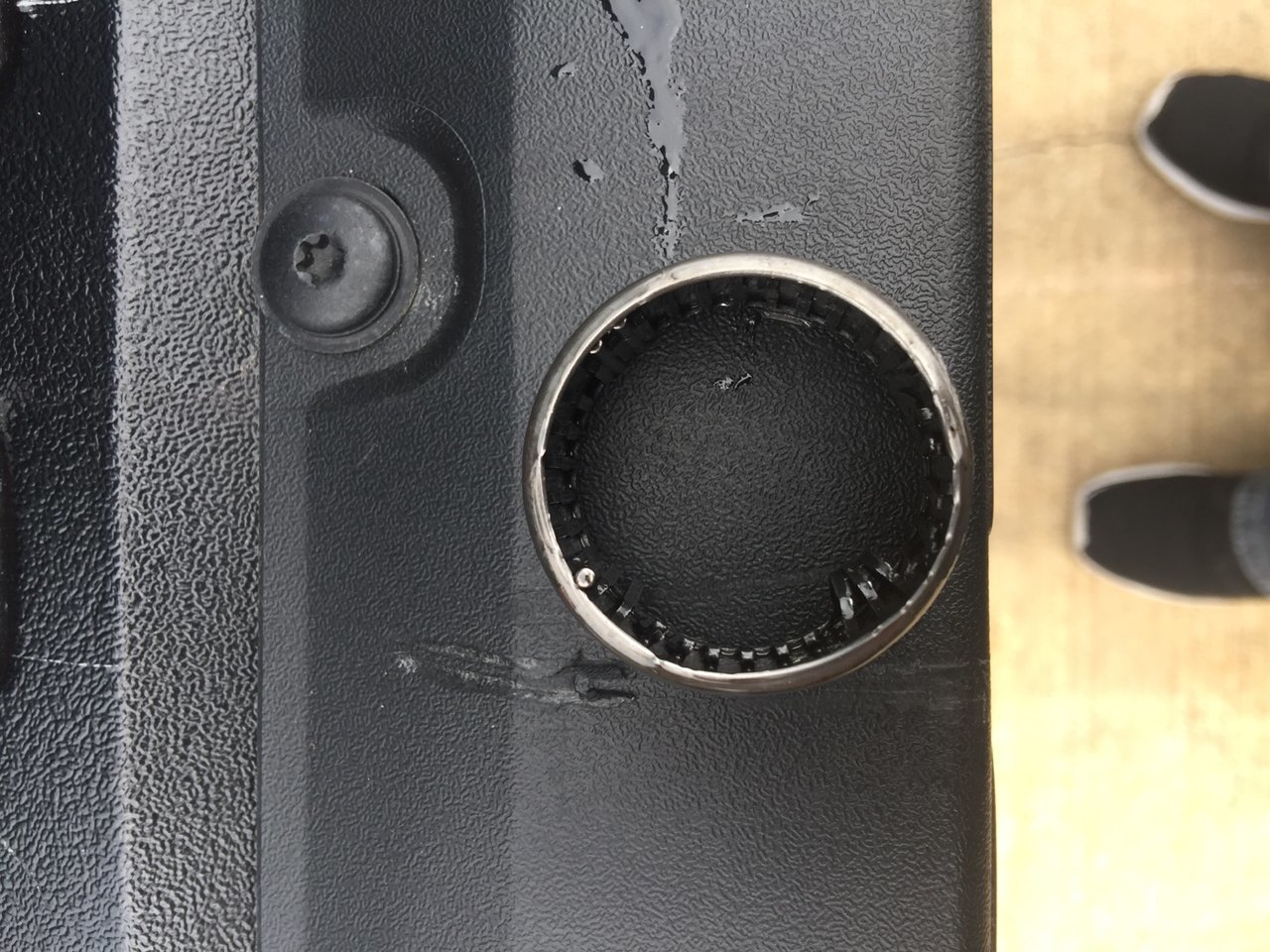

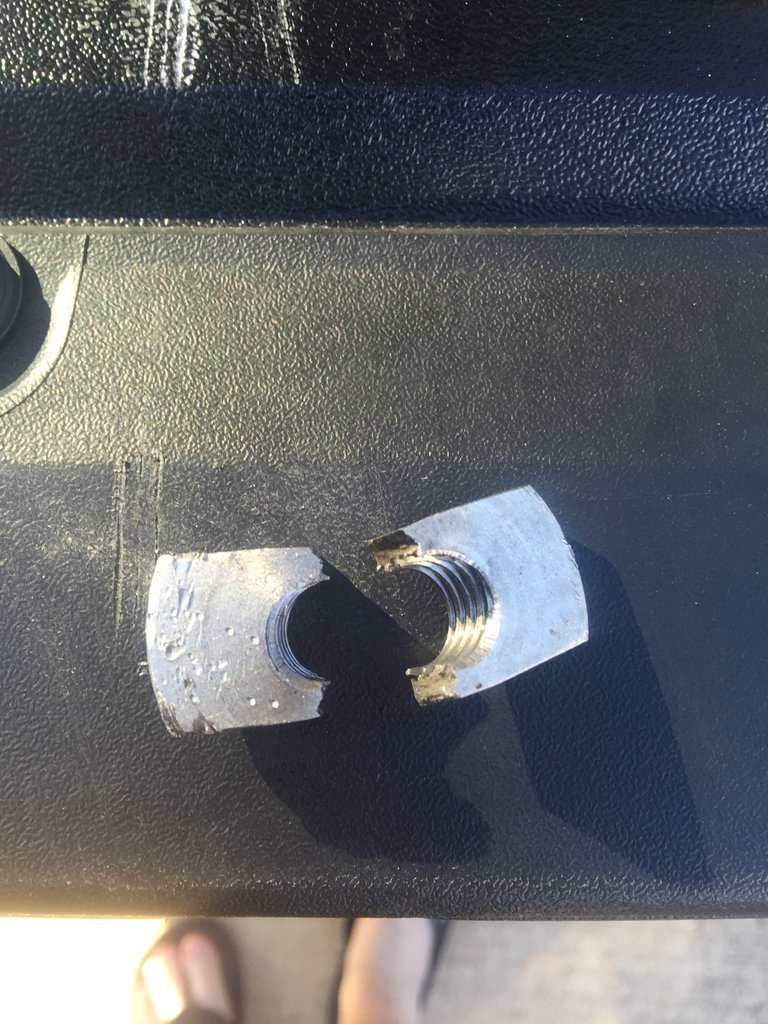

    So after a really crappy morning with family stuff, I got home and attempted to remove the bearing. Got all the way to removing it and then this happened
    So now I have to call ECGS in the morning to try to get another one of these pieces. Am I the only person this happened to? I also tried a gear puller with a slide hammer. Needle bearing is damn near stuck in there.

    :eek: I just did mine last week and it came out with little effort.

    Truck is new too. Which is why I'm kinda baffled. Figures it's my luck that it'd break on mine.

    To everyone who did this install, how exactly does the tool fit in there? Are you able to move it once it's in place, like spin it? The smaller threaded piece. I know it sits behind the bearing but I Wanna make sure it's fully seated properly this time. Bit nervous now.

    Yeah, just hammer tap it so it's behind the oem bearing then try and make it as centered as possible. If you don't see the bearing moving and the wrench starts getting really hard to turn then back off and center it again

    Should it be horizontal behind it? Or vertical? Or does it matter.

    It doesn't matter as long as it is centered.

    Sounds good. What makes me so angry is that I've done head gaskets, transmission swaps, all the Jazz. But a tiny little bearing cripples my truck. Gotta love it

    It's the same crappy needle bearing that'll fail.

    We're gonna go with a slide hammer is a bad tool for this job. PSA. SLIDE HAMMER IS BAD TOOL FOR THIS JOB.
