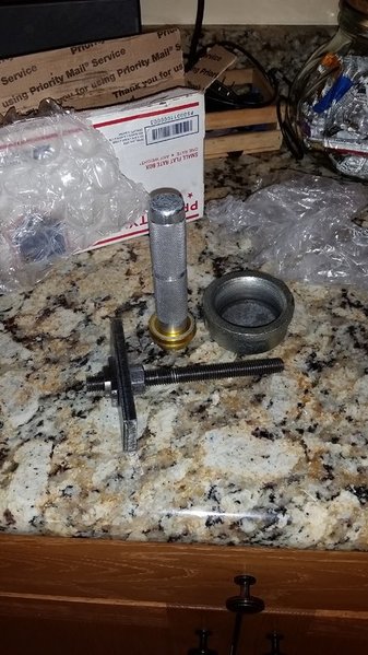

    Been reading on this post now and again. I did mine back at 3k glad I did it. I do have a removal tool that I could lend out, but am not going to send out my bearing driver, that's what large sockets are for. Ill tell you I didn't care if my warranty was messed up I didn't want to deal with dropping my truck off a the dealership so that they could hold it hostage. If you are thinking of doing this, think no more, it is worth it. I now have 15k and not one problem. 2 1\2 inch lift on the front just did it when I had the front end apart already. getting the CV out was the biggest problem I had. I just got a couple of large chisels and wedged them between the clam shell and the CV. Good luck fellas.

    Go my tools back plus the end cap thing for the seal which a member generously added in.
    Anyone in need of tools? As long as I get them back eventually

    Just received the removal tool and driver today from @Slamking18. Hoping to do the replacement on Saturday and then I will check to see who I need to send them to.
