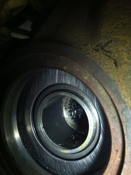

    So, almost have the ECGS needle bearing replacement in. How far do I drive this thing in? Unfortunately I neglected to see how far in the OEM bearing was seated in the front diff. Here is a photo of where it is currently:

    Drive it in until it's flush with the outside edge.

    Which "outside" edge?
    The one it's closest to or the larger/wider outside ring?

    The one it's closest to. Looks like you're just about there.
