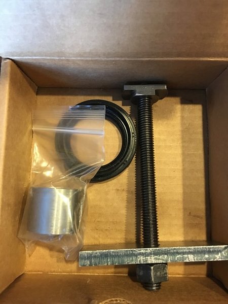

    I ended up buying the ECGS needle bearing bushing, axle seal, and removal tool from ECGS but never got around to installing it. I ended up selling my truck, so I have these parts for sale. I paid $135 plus $12 shipping for them. I will let anyone have them for $100 shipped to your door. I haven't really ever posted on this forum; however, I can take payment through PayPal, so you will have their buyer's protection so as to feel comfortable with the deal. Please PM if interested.
