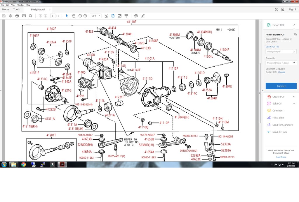

    Little help:
    Working with local dealer and I want to order the seal and c clip before I start this.
    From the pic I think I need to tell him 41332B and 41183B.
    Am I correct?
