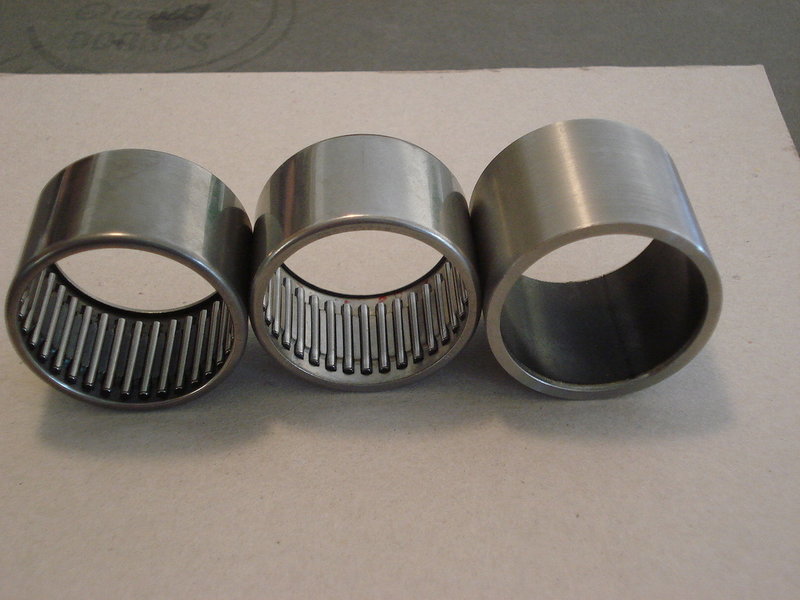

    1 1/4" spacers, leveling kit 285/75/16 A/T ECGS Bushing installed
    Old bearing on left, TSB bearing in center, ECGS bushing on right for those wondering if they are the same style bearing in the TSB. Just save the time and do the ECGS bushing because the other 2 will fail image.jpg
    4WDTrout, MTopp and camperof6 like this.

    Well that proves the TSB bearing IS different from the original, great pic. Not sure how you ended up with all three like that, but two thumbs up for you. Toyota needs to work with ECGS and fix this issue.
    MTopp likes this.

    Gotta love Toyota giving you just yet another part that will fall apart like the other. Customer Loyalty definitely goes a long way with Toyota. Glad I just went with the ECGS Bearing instead of wasting yet more time with Toyota.
