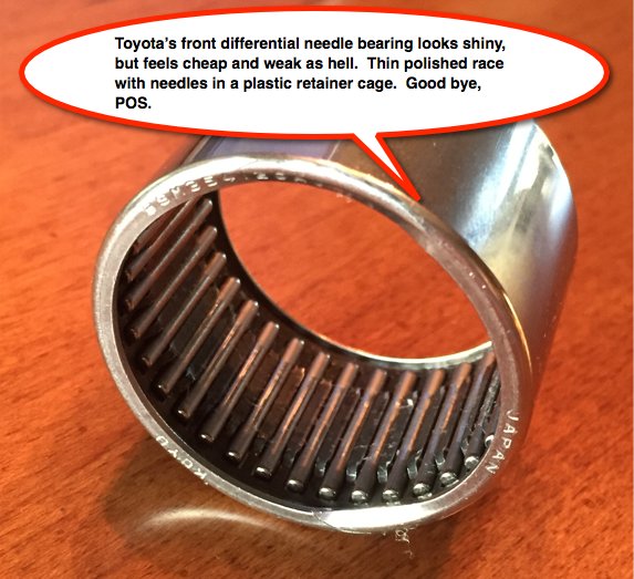

    Nothing has changed in the 2016 4x4 models. Grinding/groaning from the needle bearings occurs (especially if the truck is lifted) until they are replaced by a bushing. A TSB has not been issued covering the 2016s and I don't know if I would have wanted it anyway. Toyota would have just replaced the shitty bearings with more shitty bearings.
    See my post on the 2016 forum addressing this same issue:
    https://www.tacomaworld.com/threads...a-vibration-noise.407327/page-9#post-12268506
    Just replaced my bearings today; No more rubbing! Thanks ECGS for the fix and the team at Overbey (transmission and differential pros) in La Habra, CA.

    That bearing should be dipped in gold and put on display in every Toyota dealership, what a work of art. Just think if there were no ECGS.

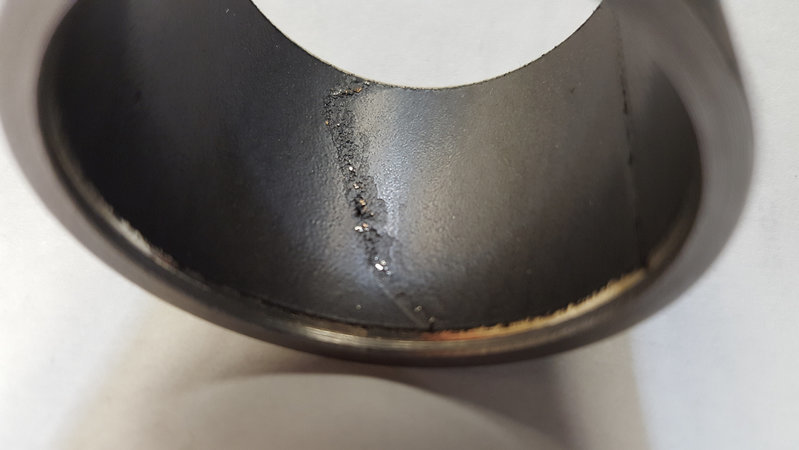

    So I got my bushing yesterday and of course there is a groove through it for oil, but did anyone else get one with a sort of deformity in it and if so should it be of a concern or just install it and run it?? Just wondering as it is going to be installed Monday. Pic attached below. Also the oil groove, would it be best to have it at very bottom when installing or does not matter?
    From what I have seen and read is it to be the consensus that all bushings installed so far have been 100% no issues? How many have removed their cv shafts after some miles and inspected for any signs of wear. I did see at least 1 person did and said no wear seen at all. Just a few questions for me to know and maybe a few others who may be wondering. Thanks

    Don't know for a fact, but I thought I read somewhere that they were going to start putting a oil journal or (groove) in them. You may want to email them that pic and make sure it's ok to install, hard to tell without touching it, but it does look a bit rough.

    As for that deformity, I'd ask ECGS, but personally wouldn't install that bushing in my truck. My bushing was perfectly smooth on the inside, minus the oil groove.
    camperof6 likes this.
