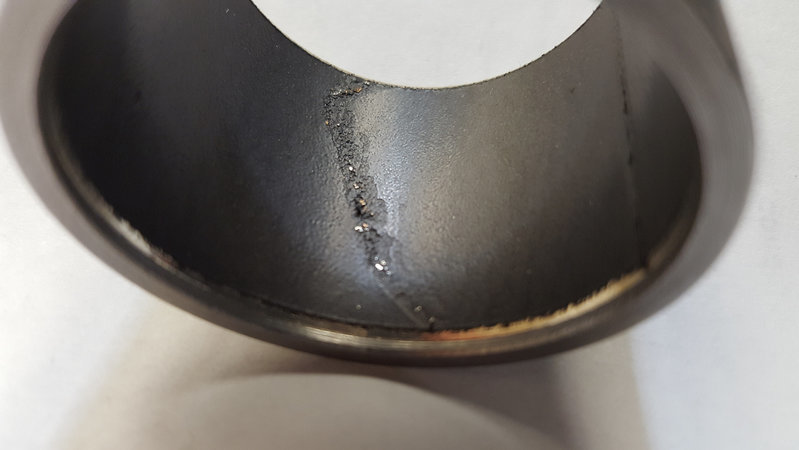

    My bushing that I had installed two days ago was mint smooth. Check with ECGS. They seem like stand-up guys. So far, so good. Nice and quiet. I saw no wear on the crap Toyota bearings and my installer reported none. I believe the noise comes from the poor tolerance and vibration from the CV against the needle bearings spinning. So far, very satisfied.

    I don't like the look of that one. I'd get another one. FWIW I ran mine for 40k+ mi with lift and vibe. The shaft showed no scoring. Except for me screwing up the seal and not getting the new one in right everything went well.

    Yeah, it looks worse in the picture than it actually is I think. Messaged Chase @ECGS on their website but they are not open Saturday so messaged him through TW here. I don't know if they actually inspect each one before they are shipped or not. It figures though crunch time is coming for my trip to Minnesota and don't really want to install a bearing and have it start making noise half way there. :(
    Anyway will see what he has to say.
    I guess I can always drive this if I have to just wouldnt be too much fun, lol

    Believe it or not I actually do and a thumbs up here and there. Also got a lot of wtf did you buy that for. Is a damn fun car to drive. If I could only get an extra 50-80 hp it would surprise a lot of people I think. 94 hp @ 2100 lbs stock. Drove around 45 miles today with little tail wind and was at 40.7 mpg. Wanted to keep going to see how high it would have gone, lol.
    Anyway regarding the bushing I think I am going to run it. With the blem at the 3 or 9 position I don't think there will be an issue with it. Just still kind of curious as to where Chase would say to position the oil groove, probably doesn't matter as some have said since oil gets splashed around in there anyway.
