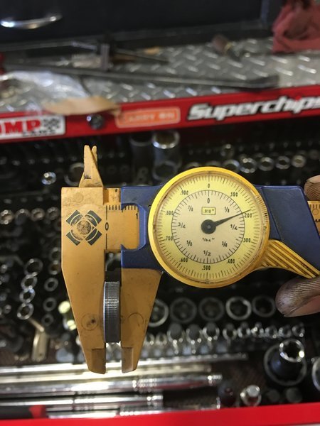

    Here ya go bubba. 5/16" exactly so exactly half of the total thickness

    Thanks a ton man, I really appreciate it.

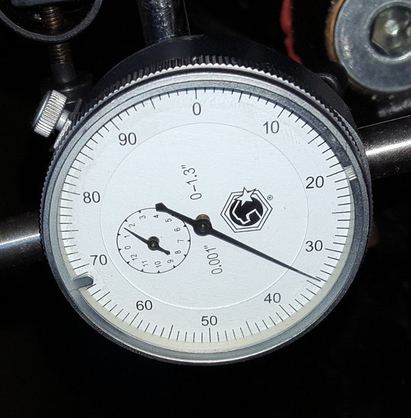

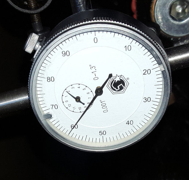

    Got out in the garage to check movement of the cv shaft since bushing install. Uploaded a video to youtube. Not sure why youtube made the video skinny like that as on my comp it is wide, oh well. Appears I have approx. .025" movement. I got it as close to the inside edge of the shaft because as most will know the further out you go the more movement there would appear to be. Also attached 2 pics of movement. I did not have the indicator zeroed because of the area I was in I could not see the zero and could not set it up any other way.

    .025 is very reasonable for movement. And just based on site the movement looks acceptable. Crawl under any IFS diff they have slop, it is inherent to the design and necessary. The reason why the toy IFS diffs make noise is a compound issue of using a needle bearing where it does not belong , supporting the side gear by the pinion gears only, and to steep of CV angle. The bushing supports the shaft better and for a longer distance so it corrects the issue but is not infallible.
    More on measuring deflection: Where you measure on the shaft effects that measurement infinitely. The further from the bushing the more the deflection so an accurate spec on that would always have to be taken at the exact same location on the shaft. When we were measuring during design phase 4+ years ago we were measuring right next to the bushing with carrier out of the case which would be the minimum amount possible.
