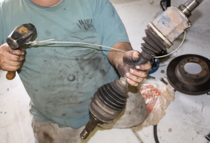

    So I'm having a hell of a time removing my driver side CV axle. Any tips/tricks? TIA

    If not, try using a slide hammer and use a hoseclamp to hold the slide hammer in one of the slots on the cv end near the diff.
    If no slide hammer, get some relatively strong rope, tie a loop to go inbetween the diff side and cv end, have the rope extend out of the wheel well and tie another strong loop. similar to this: http://southeastoverland.com/index....ct_id=174&virtuemart_category_id=57&Itemid=33
    Then use a hammer in some way to swing and pull on the cv outwards. Try a pull then rotate the cv a little, try a pull the rotate again, should pop out.
    Or use a prybar, rotate the cv, pry, rotate, repeat

    It's out! And so is the needle bearing! Thanks again @MTopp !!!

    Good CV removal tool idea, DIY inexpensive: "Here is a tip about removing the cv axle, without having to pry the c clipfrom inside the clam shell, or the use of a slide hammer
    A piece of cable from home depot, with eyelets on both sides. make a noose around the inner cv axlecollar and put a small sledge on the outer eyelet and give it a pull/tap out, to release the c clip"
