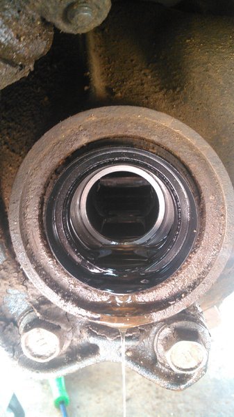

    So are you suggesting I may need to replace/rebuild my diff then?

    He is saying you may have driven the bushing in too far and need to find out how to fix it...

    Sorry, to clarify, I have the same problem in that my vibe/growl still existed after the ECGS install. I'm fairly confident in my bushing placement. I also now think my sound could be something else, possibly a wheel bearing beginning to go. My growl is most noticeable/prominent at very low speeds when it's not covered with highway and engine noise. It sounds like a low pulsating grind, and I have confirmed that engaging 4wd has no effect on the sound whatsoever. I'm going to jack up truck and check diff fluid, play in CV axle, and then spin and wiggle wheels to see if I hear anything from the bearings.
    Is it not uncommon for wheel bearings to go as early as 70k miles?

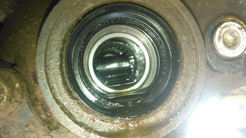

    Just confirmed it's my wheel bearings. Left is worse than right, but both are making noise and need to be replaced. Looks like I'll be ordering a pair from BamaToy or nj636.
    My front diff fluid is full and looks good, no excessive play or leaks from either CV axle, so I've no reason to believe the ECGS isn't doing what it's supposed to be. Thanks for the videos posted and the replies.
    bend, you do look a little in past flush on your bushing, maybe by an 1/8" or so by the looks of it. Although it's not ideal I wouldn't think that would cause continuing vibes. Sounds like the biggest concern from the guys at ECGS is if it actually contacts the spider gear. If you still have your removal tool, probably worth trying to grab the new bushing and pull it out a bit. Have you ruled out wheel bearings? And have you confirmed that engaging 4wd still elimnates your vibes?

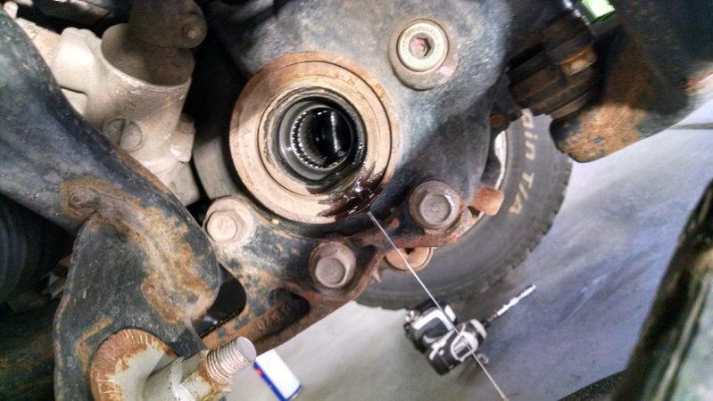

    Finally replaced my bearing and installed the bushing last night. It was surprisingly easy. The only hiccup I ran into was fighting the CV a bit to remove it. Once I pulled the diff skid and was able to get decent leverage on it with my pry bar, it popped right out. Only took one pic along the way because my hands ended up drenched in gear oil by the time I was finished.
