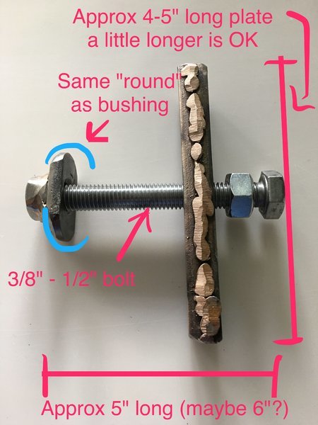

    Boom! Replaced the d/s needle bearing on the front diff and replaced both CVs and oil seals. Total success. The truck is WAY quieter but the real test will come in the morning when I get her on the highway. The only problem is that the p/s oil seal appears to be leaking slightly. Nothing major but definitely a drop of gear oil every 6 hours. Hopefully it will seat and quit leaking otherwise I'm gunna have to pull that apart and see what the dealio is. I'm 99.9999% sure I got the new seal seated the same way the old one was. Ho-hum.
    Oh, and btw, I made my own needle bearing puller. Ain't pretty since I'm a novice welder, but it worked like a charm. The old needle bearing doesn't even have a nic on it. If anyone wants it to do their bearing-to-bushing job, lemme know and we can work something out. Happy to send it on to whoever needs it for the cost of a usps small flat rate box price.

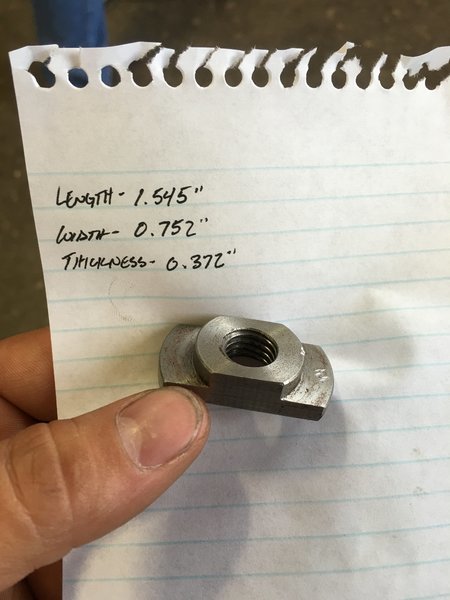

    would you mind giving measurements of the tool? bolt size, plate length width and thickness, details about the end piece...
    I'm confident enough to make my own but I need it to be right the first time. I don't have a back-up vehicle for if I don't get the truck finished in a weekend...
    rant warning: $60 for a tool that they have under $5 in material cost!?!?! and $20 for the seal?? charge whatever you want for the bushing if it fixes the problem but come on... the removal tool and seal should be HALF of what ecgs is charging... :rant:

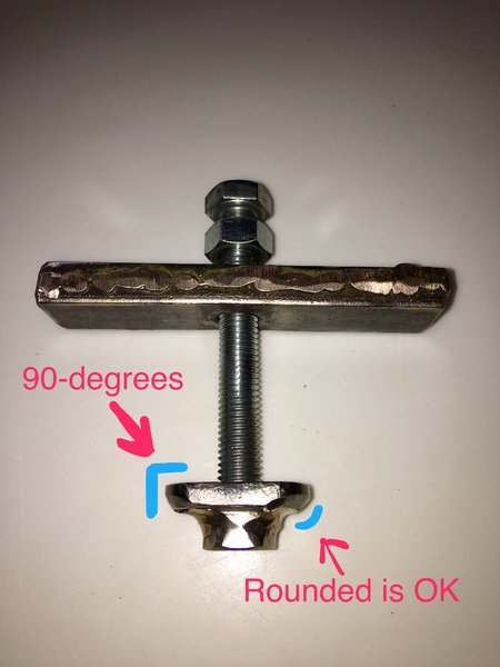

    Ya, I was a little annoyed by a $60 tool when the part is the same amount. Meh. I guess some people don't have the shop tools to make the removal tool. Really all you need is a grinder- the rest you can get from a big box store for under $10.
    I don't have the exact measurements, but what I did was measure the OD and ID of the bushing when it came in. Then welded a nut to a piece of 1/4" (or so) thick plate steel (obviously with a hole that the bolt would slip through). I ground down the plate until it was smaller than the OD of the bushing but still bigger than the ID. The bolt is about 6" long. Longer would be ok, but you won't need it longer than 10". Any shorter and you wouldn't have enough bite on the nut/plate piece. The larger plate(s) (with a bolt hole too) are about 4" long. Those could be longer (like 6") b/c there's plenty of room to work with. This is the plate that presses on the outside of the differential. I threaded a nut on the opposite end from the plate/nut piece. This nut is tightened and it will pull the bearing out (assuming the bolt doesn't spin in the plate/nut piece. That's why I used a bolt (versus a threaded rod)- so I could hold the bolt from spinning. Vice grips on a threaded rod would work too if that's all you have.
    Make sure you stuff a plastic grocery bag in the diff past the OE needle bearing. You'll might have to get the nut/plate piece started while threaded on the bolt, remove the bolt and tap the nut/plate piece so it slips behind the OE bearing. If you don't have a plastic bag in there the nut/plate piece will fall into the diff. I just gave it a little love tap and it popped in behind the OE bearing. Viola!
    Wait til you get the bushing in the mail before you make the tool. I'm no machine-shop, mechanic and was able to come up with a bang up tool just by looking at pictures and using common sense.
    Oh, and the plate/nut piece should be rounded on the ends so it doesn't mar up the bearing race. You can follow the bushing as a guide as to the roundness needed. Just don't over grind the side that's gunna be in contact with the OE bearing as you're removing it. Kinda hard to explain, but the plate should be 90-degrees on the side that hits the OE bearing. The side of the plate/nut piece opposite from the bearing-pressing side can be a little rounded. Look at the pics and I think you'll get what I'm saying.
    The bolt is about 3/8" or 1/2". Just big enough to have meaty threads that will withstand the torque of removing the OE bearing.

    Here's a pic with a mark up regarding the 90-degree comment from my previous reply.
