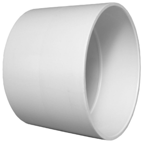

    axle seal must be flush with the housing, not driven all the way in. I think I used 2" pvc pipe with a 2" coupling to drive the seal.

    A 2" pvc coupling is perfect for the passenger side seal. Didn't even use any pipe - just tapped on the coupling itself. Viola! (Oh, and I froze it before install)

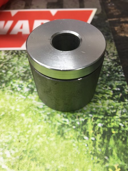

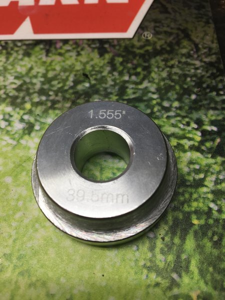

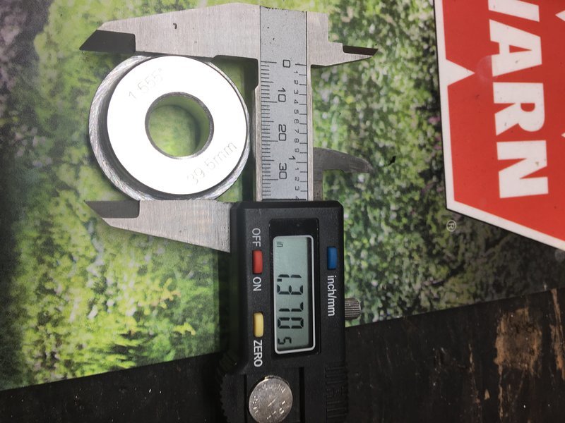

    If you ordered the same one I did, the smallest driver is too large and will not insert correctly into the new bushing. I roughly machined mine slightly smaller than the bushing.
    The id of the bushing is 1.38 per my hf caliper. The od of the driver is 1.40 before I machined it down.
    I believe if the driver is used as is, it will damage the bushing.
    This is the driver I ordered. https://www.amazon.com/gp/aw/d/B005SMUOR4/ref=yo_ii_img?ie=UTF8&psc=1

    I used a 2" slip to slip, but that ought to do it as well.

    No, that's an inside slip/threaded coupling. Should be the outside slip coupling like the picture I posted below. There's a little rubber lip on the axle seal (well on the passenger side seal anyway) that is almost exactly 2" in diameter so it will slip inside the pvc coupling and the outside ring will make contact with the coupling. That way you are tapping on the whole surface of the seal and not just one side at a time.
