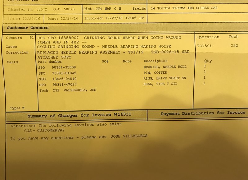

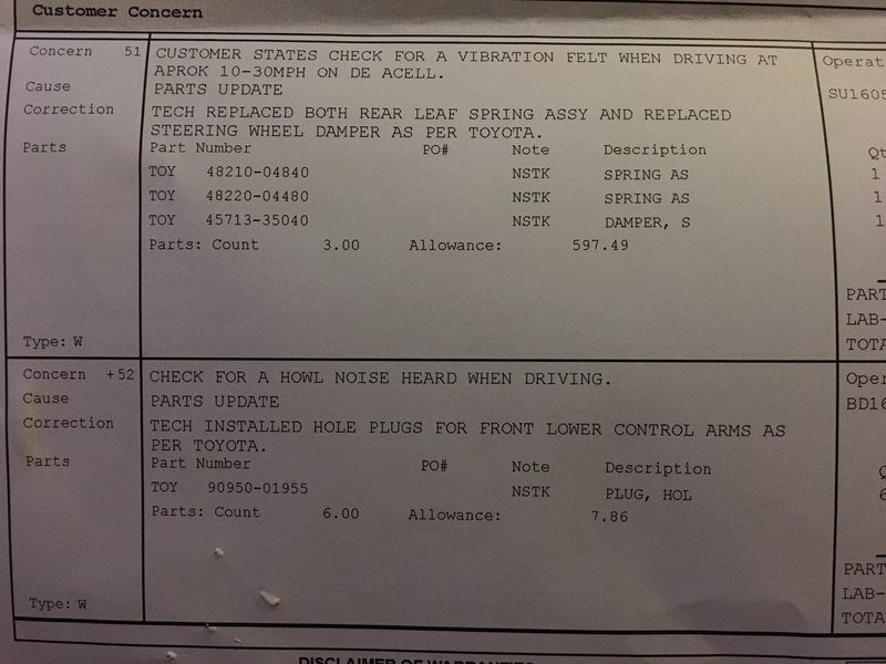

  12. Jan 20, 2017 at 3:39 PM
    #3832
    lloverso
    lloverso Active Member
    Dec 30, 2016
    #206052
    39
    Pa
    2018 Tacoma TRD Off Road
    ProComp 3/1 Nitro Level Kit Diff Drop Spacer 17x9 Method 312 -12 Offset 285/70/17 Nitto Terra Grappler G2
    Had the ECGS bushing installed today. Also had the TSB for the new leaf packs, steering damper as well as the TSB to plug the lower control arm holes. The good news is the vibration is GONE!!!! The truck rides really smooth so far and the horrible vibration I had is gone. The bad news is since they installed everything at once I can't say for sure which actually fixed the vibration. If I had to put my money on one it would definitely be the ECGS bushing for sure!! I highly recommend upgrading to the bushing.

  15. Jan 23, 2017 at 3:18 PM
    #3835
    lloverso
    Dec 30, 2016
    #206052
    39
    Pa
    Here are the parts they used for the TSB repairs. I did not bother to have them install another Toyota needle bearing since the vibration will only come back and you'll have to replace it again. I got the ECGS 8" clamshell bushing from the East Coast Gear Supply website.
