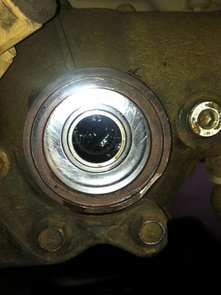

    Finished the install today. Left the bushing sticking slightly out and the seal sticking slightly out. So far no leaks.
    Very easy straigh forward job.drivers side Cv was stuck again.had to use the homemade removal tool lol

    Well the damn thing still leaks oil !!! So frustrated at this point

    You an after market CV in? Only other reason other than damaged seal is that you didn't drive the seal flush with housing.

    Anthony, I have the same truck you do and did the ECGS fix in the front diff with my bro. We drove the ECGS Bushing flush with the inner ring(housing). Here is what mine looked like:
    Other than that, make sure your using new seals and they are seated correctly.
    Hope this helps

    My problem is the seal.. Everyone is telling me it goes a different way. Half have said glove side goes into diff...other half have said glove side goes out toward cv axle image.jpg

    I have not done mine yet,but the glove side is almost always outside on most everything else.Best too look at the one in the truck BEFORE removing it too see how it fit's.

    I honestly can't remember...sorry. I wish I could be of more help. Maybe Kevin can chime in @nj636

    Can the bearing be swapped without doing the seal? Not against doing the seal but don't want to create a leak by swapping if I don't have to. Very curious on which side goes in per previous member question too.

    The side showing there is the outboard side. You should see a small metal spring on the other side on the inside lip.
