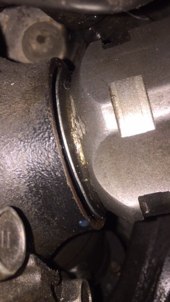

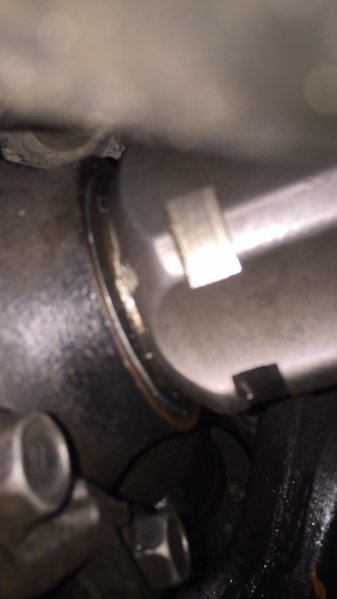

    I am having the same issue with my ECGS bushing.
    The bushing and seal replaced 30k ago now leaking in the same area as your pics.
    going to pull the axle and check the bushing and replace the seal while I am in there.
    what ended up fixing your leak ??

    Nothing....just went and checked again and it's still leaking...running down and dripping off the bottom
    Don't know whether to replace the cv and seal or just the seal
    What are the odds it's the cv ?
