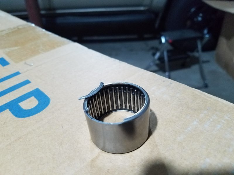

    Thanks @pm321. Installed ecgs bushing today w no major issues. Original needle bearing had a piece snap off that I couldn't pick up but the magnetic pickup tool did the job.
    I am waiting to hear back from a tw member who pmd me about the tool. If he no longer needs then I can ship to you. If not he should be able to ship to u when done if needed.
    Thanks to @Unchained 5150 maybe this ecgs removal and install tool will eventually have the most miles travelled of all tools being passed around on tw
