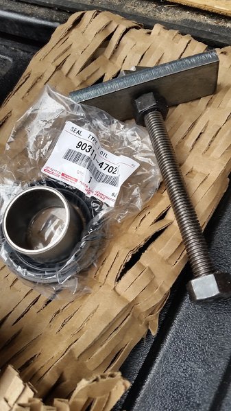

    Well, i ordered the bushing today. I have a very faint vibe around 30mph. I am just guessing that it is the needle bearing problem. It seems to be more pronounced when the truck is cold. It's hard to feel/hear when the truck is warm. Could it be anything else? What other tools will make this job easier? I have the bearing removal and installation tools.

    Yes.
    The "bolt" seen here is used to pull the oem needle bearing. You can use a variety of things for removal and installation but I feel more comfortable using something I'm confident of.

    2018 T4RTRDOR
    I have that removal tool, I just read somewhere up above about a installation tool. Didn't know if I was missing something?
    I figured a socket on a 6" long extension and a hammer will work just fine for getting the bushing in place. :fingerscrossed:

    Yes, there are bearing/race drivers but you should be fine with the right size socket or piece of pipe.
