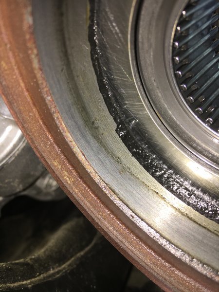

    IMG_2662.jpg Any of you guys see anything like this when you replaced the seal? It's like a really rough groove inside the seal housing.

    I didn't replace my seal. No leaks after about 4,000 miles.

    You should be fine. My understanding is the extra lip is just to keep you from damaging it on install. I wouldn't worry about it.
